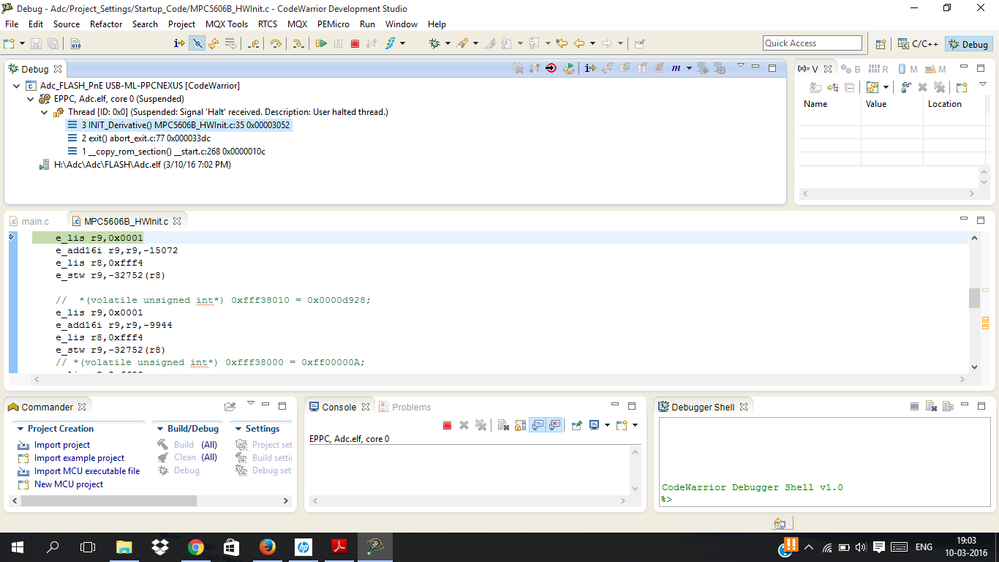

in codewarrior  when i start the resume button it automatically stops.

akhilmalik
hi
the problem still exits
i have attached the screenshot . u can  see what happens !!!

martin_kovar
please send me the whole project. I need to investigate deeper.
Martin

martin_kovar
I have tested you code and I found that program stops in function adc_power because of while loop. You are not able to write to ADC_0.MCR register, because you did not enable peripherals during mode transition and ADC is frozen. Replace the code in initModesAndClock by this code:
ME.MER.R = 0x0000001D;          /* Enable DRUN, RUN0, SAFE, RESET modes */
CGM.FMPLL_CR.R = 0x01200100;    /* 8MHz xtal: Set PLL0 to 64 MHz */
ME.RUNPC[0].R = 0x000000FE; /* enable peripherals run in all modes */
ME.RUN[0].R = 0x001F0074;      /* RUN0 cfg: IRCON,OSC0ON,PLL0ON,syclk=PLL */
/* Mode Transition to enter RUN0 mode: */
ME.MCTL.R = 0x40005AF0;        /* Enter RUN0 Mode & Key */
ME.MCTL.R = 0x4000A50F;        /* Enter RUN0 Mode & Inverted Key */
  while (ME.GS.B.S_MTRANS) {} ; /* Wait for mode transition to complete */
  while(ME.GS.B.S_CURRENTMODE != 4) {}; /* Verify RUN0 is the current mode */
Now, you should be able to execute adc_power function.
