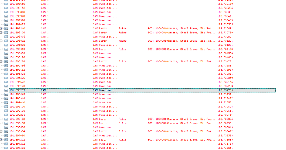

   I found when I enter the Bus Off too long(5min~15min) ,the chip will enter the Error Passive state and will not recover .

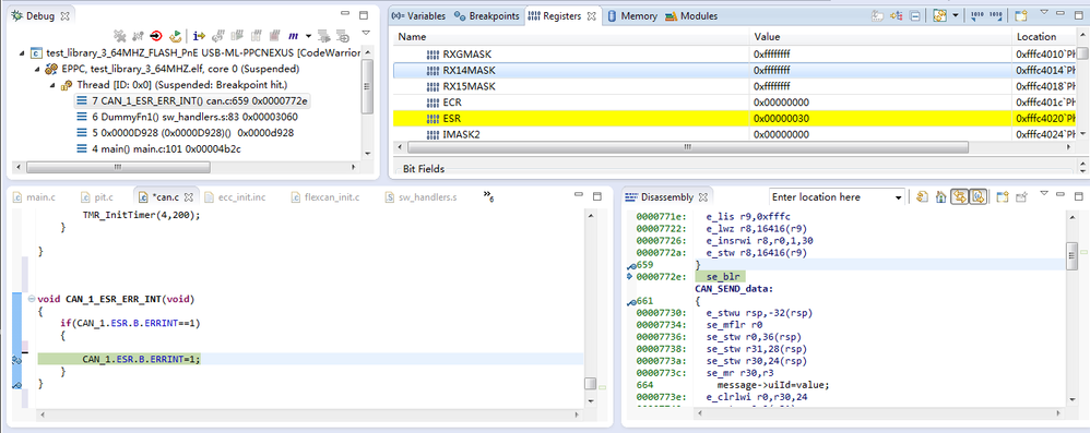

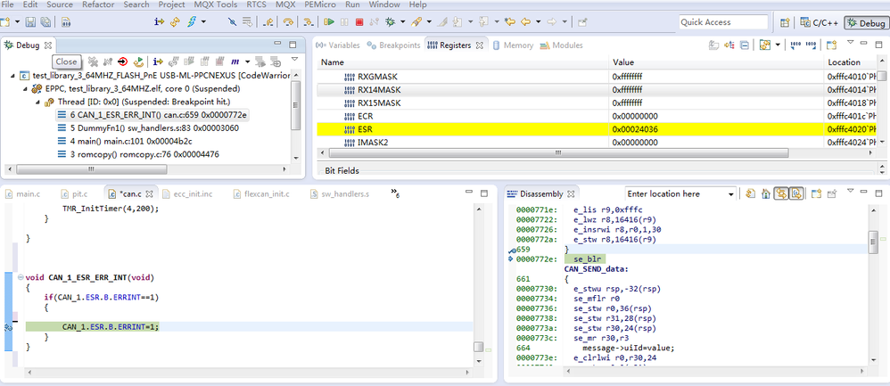

Moreover ,If I set the Error Interrupt, it will not enter the Bus Off Interrupt .When I clear the Error Interrupt flag ,the chip wil clear both of them .So it still in Bus Off state and will not recover .

First of all, be sure the full register access is used to clear particular IRQ flag. The flag is cleared by writing 1 into a bit position, so if the bit access is used, read-modify-write operation is done and so other flags may be cleared unintentionally, causing not generating the pending interrupt.
See more in following EB758 document; http://cache.freescale.com/files/32bit/doc/eng_bulletin/EB758.pdf.
