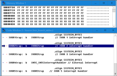

I am using MPC5604P in Debug mode. During the Data Flash reading test, I found that when reading the first address (0x804000), the data reading was normal. However, when reading the second address (0x808000), I entered IVOR 2 interrupt, and the memory window displayed the data starting from address 0x808000 as' XX '. What is the reason for this? I look forward to your reply.

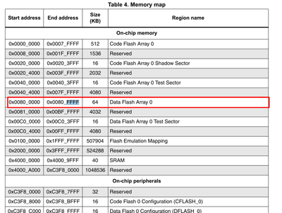

I assume that is uninitialized memory full of ECC faults. Could you try erase the whole micro?
0xFF means erased memory, XX - I expect is multibit ECC fault read by debugger, or reserved memory area.
Looking at memory map, there is data flash 0:

Does erased micro trigger IVOR2 also? I do not expect. So I suspect the issue in your SW.

If you erase the micro can you read the data correctly from memory via debugger? is there 0xFF?
