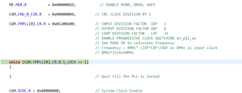

Hello all,
I'm using MPC5602P device.
I wrote the code so as to initialize the clock with PLL. The code stuck as shown in the below screenshot.
Kindly help in this regard,
Raju

davidtosenovjan
Hi, here you may find a example code showing also PLL setting:
Example MPC5604P PinToggleStationery CW210
Also I may recommended following excel tool:
https://community.nxp.com/docs/DOC-332694

Hi David,
Thanks for your response.
I used one of the example projects to develop the code and it has been working normally all the time.
I solved the issue it is actually the debugger cable connecting to the board is loose.
Once again Thanks for the support,
