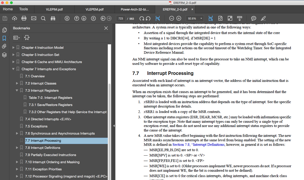

I am not able to figure it out which instruction to use from  MPCxxxx instruction set for PC and PSW. what are the  actual Program counter(PC) and program status word(PSW) equivalent  registers in MPCxxxx instruction set.

In  second part i can use MSR register bit EE to disable the interrupt (if not correct please let me know which one to use and how to use it),
In second part , in MPXxxx instruction set Which register says the exception handling , which register i have to access to say that i have handled the exception occurrence.

Hi Vijay, did you check EREFRM_2-0.pdf Chapter 7? KR

please see attachment in this post.
