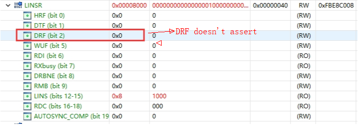

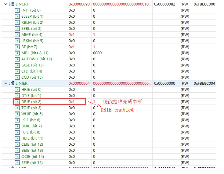

we are using the MPC5746C LINFLEXD in our project, the LIN8 is configured to UART mode.
we now try to use the FIFO for Uart RX, and read the FIFO in ISR.
But seems like the "Data Reception Complete" interrupt didn't trigger if I the RX FIFO mode enabled. please check below screenshot for my debugging.
could you please help me to firgure out how to use interrupt to read data from RX FIFO.

davidtosenovjan
RxFIFO and TxFIFO interrupts of LinFlex in UART mode works in the opposite way than one would expect -
DRFRFE is set when the Rx FIFO is EMPTY and
DTFTFF is set when the Tx FIFO is FULL.
The operation that would be expected is an interrupt when the Rx FIFO is NOT EMPTY and when the Rx FIFO is EMPTY. I would recommend to use either polling mode or interrupts with buffer mode.
Also DMA transfers sources use different conditions (here Tx/Rx FIFO is mandatory) what's propably fits your needs:
!TFF & DMA_TEN = TxFIFO is not full
!RFE & DMA_REN = RxFIFO is not empty
5,909 Views
