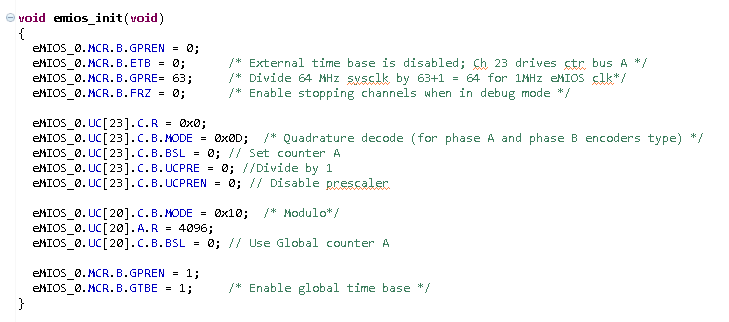

Ok now Im trying to drive global counter A with the encoder events.
So I'm configuring UC[23] in QDEC mode and this channel is working fine, I can see the internal counter of UC[23] incrementing correctly but I am not sure if counter A is incrementing
Now I want to configure for example UC[20] with a modulo 4096 driven by counter A, but unfortunatelly this does not work.
Here is my configuration :

unfortunately counter wrap (e.g. 4095->0 when counting up, 0>4095 when counting down) is not supported by HW for QDEC mode. Neither I do not see SW workaround. You can set CADR register to generate flag on counter match, but this does not bring big benefit.
When ch 23 is running in QDEC mode, its internal counter is providing counter bus A.
If using MC, MCB modes the internal counter is always selected.
BR, Petr
