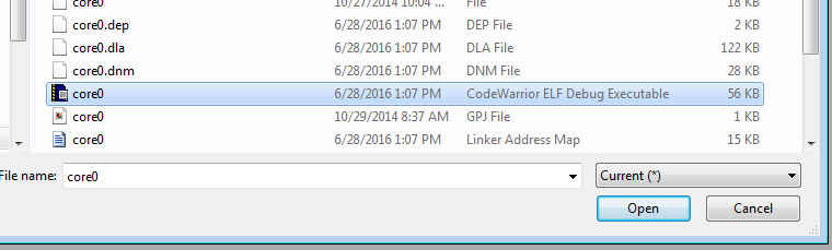

To be able to see the C code, you can use these two ways in trace32:
- when you load the code to flash, load the elf file:
Just example:
When elf file is load, you will see all the debugging information in the debugger now (assuming that the project is compiled appropriately and all the source files can be found at specified paths).
- if the code is already loaded in flash then you just need to load debugging information from the elf file (without flash programming). It can be done simply like this:
data.load.elf your_file.elf /NOCODE
