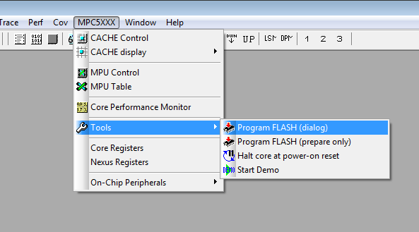

lukaszadrapa​  So here is the complete scenario:
1. Flash the application elf file using JTAG debugger from lauterbach (the application contains the BTL inside).
2. After that we use DMA to copy the BTL from FLASH memory to RAM at the desired adress.
3. The BTL will then erase the whole flash and then write to it a complete 6Mb file.
So when the BTL is running on RAM , i want to debug it ...
Indirectly related to the question: i have a problem while running BTL code and then it generate "bus error generated by CPU" when trying to flash the application again and also "Target processor in reset" for another board. Using halt core at power on reset didn't solve the second issue and for the first one the application continue to load into flash but when it reaches about 80% it give me the error ""bus error generated by CPU" "
i'm using trace32 and eclipse.

lukaszadrapa
does it mean that the bootloader can be used only one time? If so, why? You can flash the 6MB file directly... If some problem occurs during programming (communication error between bootloader and host or whatever else) then it's not possible to recover without JTAG device - you would have to program the bootloader again by JTAG...
Are you sure that the UTEST area is disabled for programming?
If you got message "bus error generated by CPU" then the image probably contains addresses out of flash. I guess it could be caused by wrong linker file. You can check the map file. Or the fastest way (from my point of view, at least) is to generate s-record file and check the addresses in the file. The s-record file is not generated by S32DS by default, so change the settings: Project -> Properties -> C/C++ Build -> Settings -> Cross Settings. Here enable "Create flash image". Then build the project and find *.srec file in Debug folder. Check the addresses if all of them fall to flash area.
