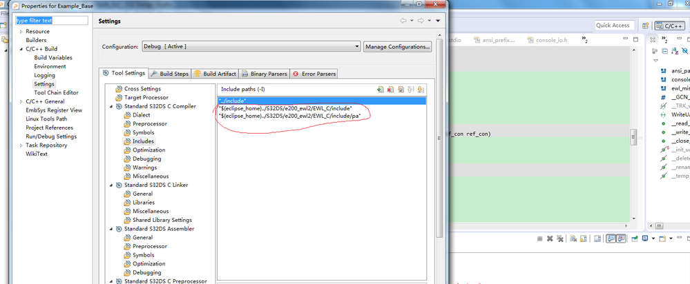

But i still have another problem. Since i choose the newlib, i find that the "uart_console_io.c" file doesn't work well.   "uart_console_io.c" file has three include file :
#include <ansi_parms.h>
#include "console_io.h"
#include <ewl_misra_types.h>
The three file could not be found. So add the path(you can see in the pic below)无标题.png
After that the project build OK. But when the program runs, i find that the printf can not send anything.
I put a breakpoint at function "__write_console", and find that the program doesnot stop at the function "__write_console".
So i guess that the printf does not call "__write_console".
Need other settings?
