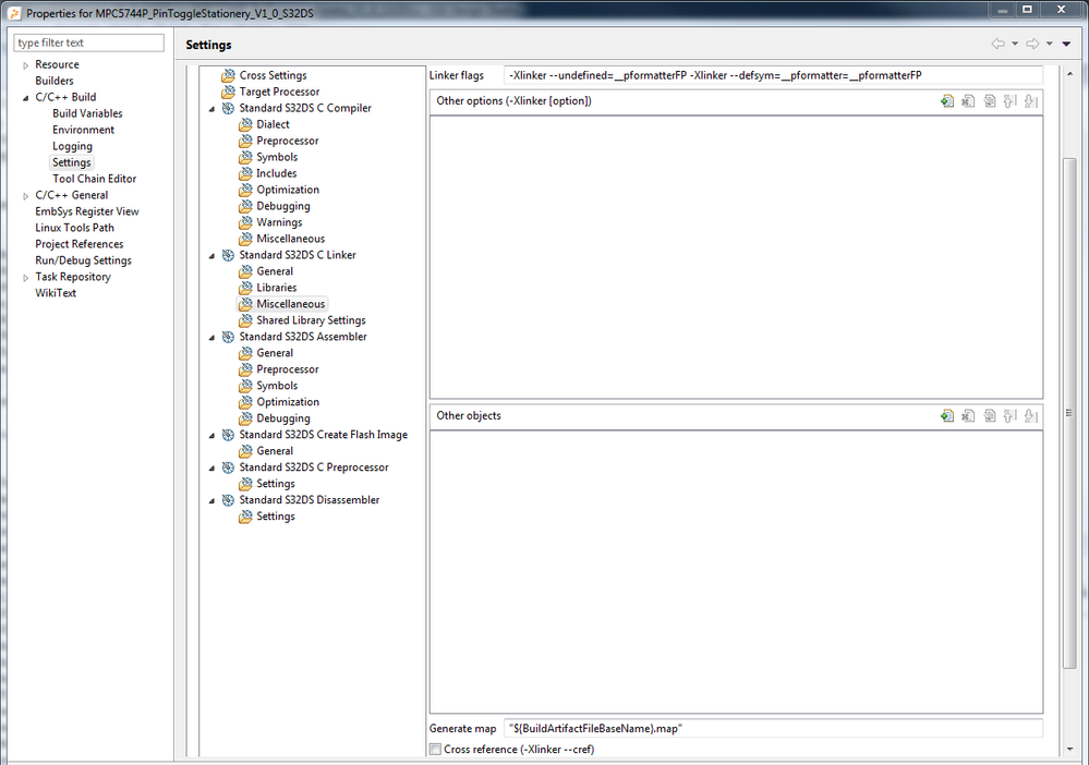

martin_kovar
at first, I would like to apologize for my previous claim. EWL library supports formaters like %d or %f. There is completely different issue, which can be easily fixed.
Add the following line to the Linker flags:
-Xlinker --undefined=__pformatterFP -Xlinker --defsym=__pformatter=__pformatterFP
Now it will work correct.
Martin
8,969 Views
fyw
Thank you very much! It works!

martin_kovar
S32DS uses gcc compiler and linker and these are under GNU GPL license. So the documentation is public, please look at the following URLs.
https://sourceware.org/binutils/docs/ld/
https://www.google.com/url?sa=t&rct=j&q=&esrc=s&source=web&cd=2&cad=rja&uact=8&sqi=2&ved=0ahUKEwjWrK...
About "-Xlinker --undefined=__pformatterFP -Xlinker --defsym=__pformatter=__pformatterFP", it is little bit complicated, but I will try to explain.
When you call printf with some formatter, for example printf("%d",0xAA), function int_t _EWL_CDECL printf from printf.c file is called. In this function, __pformatter function is called. But this __pformatter calls function from stdio_api.h, which is not correct. Correct function, which has to be called is function __pformatterFP placed in  __printformat.c file.
So the linker flag says that there is undefined symbol __pformatterFP (part -Xlinker --undefined=__pformatterFP) and define symbol __pformatter as a __pformatterFP (part -Xlinker --defsym=__pformatter=__pformatterFP ). So from my point of view, symbol __pformatter is replaced by __pformatterFP. Now correct function is called and the program could be compiled.
