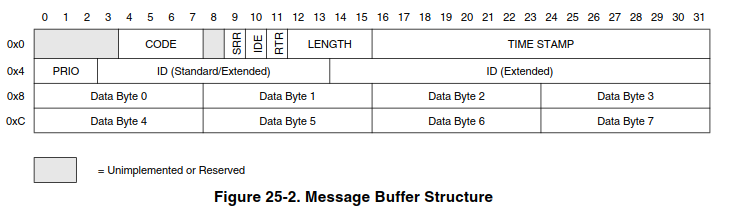

I am working on re-configuring FlexCAN Mailbox definitions for MPC5606B processor.
I am asked to make 32 Rx and 32 Tx Mailboxes ( 64 total ) able to receive/transmit messages with any IDs ( what means : Mask==0, Filter==0 ).
In the project I am working on all Mailboxes are defined using the following structure :
typedef struct
 uint8                                   length;
 Can_MbDirectionType       ioType;  /**< RX or TX */
 Can_FilterMaskType          filterMask;
 Can_IdType                        id;
}   Can_HardwareObjectType;
as an array of 56 objects of “Can_HardwareObjectType”,

As I am expected to make all Mailboxes receive/transmit messages with any IDs, I am re-defining them like this :
For Rx Mailboxes :
  0u,                                          /**< Length (bytes)  */
  CAN_DIR_RX,                        /**< Direction  */
  (Can_FilterMaskType) 0x0,     /** Filter */
  0x0u,                                       /* CAN ID */
For Tx Mailboxes :
  CAN_DIR_TX,                         /**< Direction  */
  (Can_FilterMaskType) 0x0u,  /** Filter */
  0x0u,                                       /* CAN ID */
My questions :
  1)  Am I defining them right ?
  2)  What should I specify for “Mailbox Length” field if I want to use the Mailboxes for receiving/transmitting messages with any IDs ?
Any ideas ?
Thank you for your help.

Hi Konstantin,
It could be, if the MB is properly filled from your given structure. The MB area is following...
2 facts must be considered.
- if you want to receive all IDs with both standard and extended format at least 2 MBs must be configured for reception one with IDE bit cleared (standard ID) and second with IDE bit set (extended)
- if RX queue is disabled, MCR[BCC]=0, the received message will be stored always in the first prepared RX MB, others will be never used.
Length does not depend on ID.
For a RX MB, length is don't care, it is written by module once message is moved-in based on message data payload.
For a TX MB, length specifies how many bytes will be transmitted.
BR, Petr
