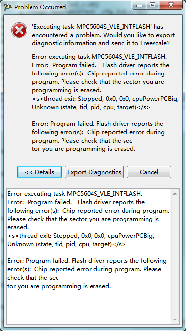

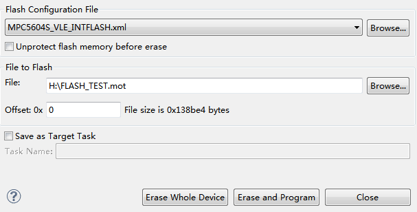

I'm using Flash file to target and everything is ok at begining,but when downloading 0x000014D8 bytes to 0x0003ED38  the promblem occureed,the chip is MPC5604S,and i'm sure the mot file is ok and the chip is whole erased

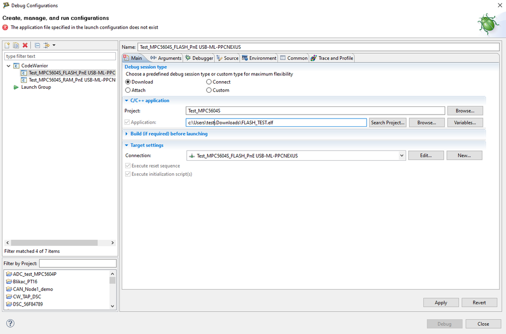

According to the screenshot you are programming code Flash.
Are you able to program your MCU using CodeWArrior Debug configuration instead of "flash to file" feature?
Do you use a custom board or NXP/freescale one?
Which debug probe are you using?
Stan

wwww
    i am use a custom board with PE Multilink Universal,16pins, and i can use Debug to program MCU.

if programming MCU via Debug iis fine then I'd suspect there is an error in Flash to file component.
In order to be able to reproduce we'd need your .mot file could you share it with us?
there are two approaches - either publically (simply post it here) or you can create a support ticket (https://community.nxp.com/docs/DOC-329745 )

wwww
hi,
    i just delet the error address range  in the mot file and tried program again,it's succeeded.
    the mot file was generate by the IDE, dose it possible that the code in this address has problem?

stanish
Thank you for the update. Let us apologize about the delay.
we are able to reproduce the issue on our side. Indeed this seems to be a bug in Flash configuration file/Flash to File component.
I've logged this issue into our defect tracking database under the number CWM-706.
