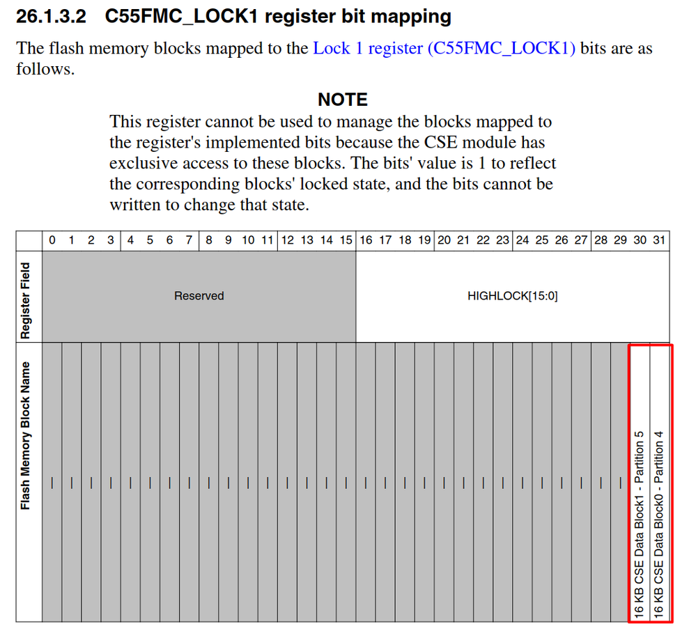

I have some questions on the Flash system:
  • Is there any significance or meaning to the Block Type attribute (Low/Mid/High/Large)? Is it some convention indicating where they are located in the memory map, although "High" doesn't seem to be in the high area and "Large" doesn't seem to fit the other terms.
  • Can someone confirm that you can execute code from the lower flash areas (RWW 0,1,2,3,4,5):

  • Why do RWWs 0,2 have a Block 0 but RWWs 1, 3 have a Block 1 (and not a Block 0)? Any significance to this?
  • If you do not use the CSE can the RWW 4 and 5 be used for any code or data use?

CSE flash blocks cannot be used for general purpose functionality because of reason below:

The block type affects mainly endurance and data retention as you can see below (datasheet screenshot):
You can execute code from the lower flash areas, but areas with higher endurance (smaller block) are mainly intended for EEPROM emulation, but you can execute code from these area as well. I am not completely sure about CSE blocks, I am finding it out, returning to you.
Regarding blocks and partitions, blocks are numbered in ascending order withing one block type, partitions the same way withing the whole flash. Just matter of implementation.
