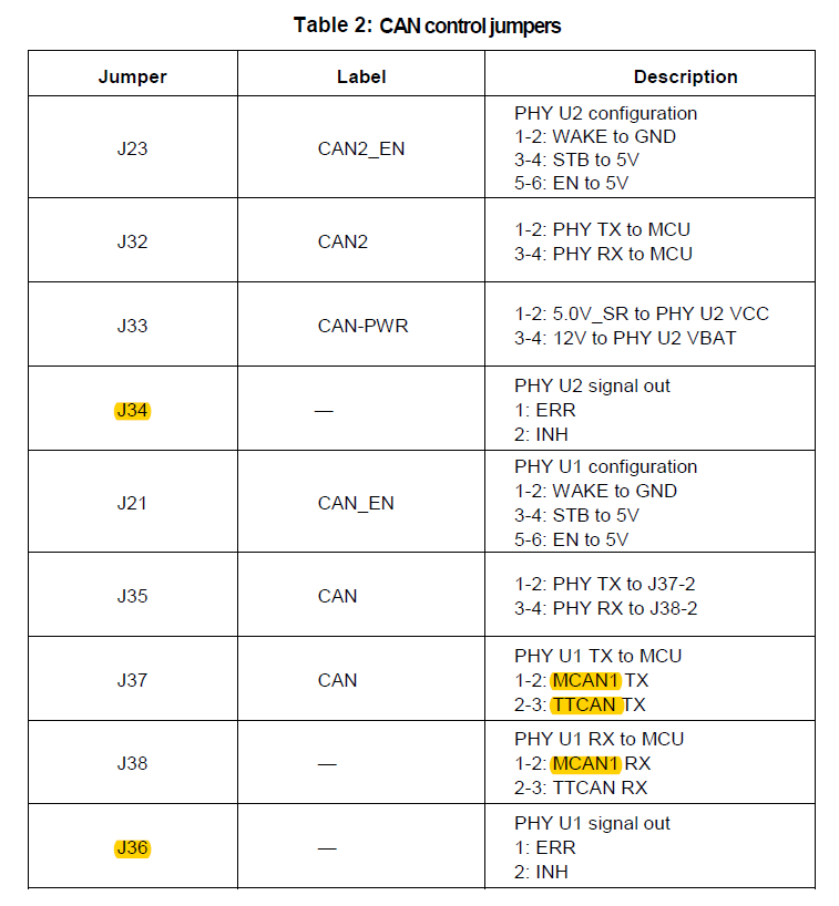

1. On the motherboard reference manual (MPC5777CEVBUG), there're two DB9 connectors, J5 (CAN2) and J6 (CAN). For CAN2, I couldn't see which CAN BUS module it is connect based on "Table2: CAN control jumpers", it said it
connect to PHY TX/RX, but I don't know what PHY TX/RX is. Can you tell me what CAN module the J5 connected to?

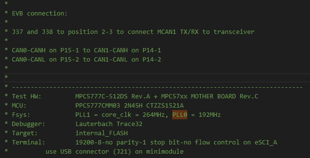

2. For J6 (CAN), I can see that by put jumper J37 and J38 to position 1-2, it will connect to MCAN1 TX/RX. But from the example that Petr wrote, which states: "the EVB connection: J37 and J38 to position 2-3 to connect MCAN1 TX/RX to transceiver", which is conflict with what EVB manual states, which one should I go? And what does "CAN0-CANH on P15-1 To CAN1-CANH on P14-1" actually meaning? What is P14-1 and P15-1?

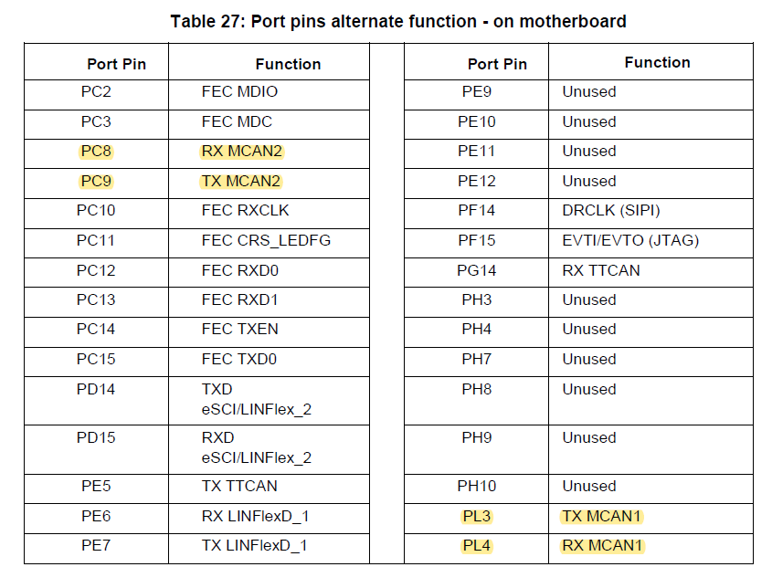

3. From the EVB manual, it said that pin PC8 should connect with function RX MCAN2, PC9 to TX MCAN2; PL3 to TX MCAN1 and PL4 to MCAN2. But on MPC5777c, there's only MCAN0 and MCAN1, not MCAN2. So should I treat MCAN0 on the processor manual as MCAN1 on the motherboard manual, then MCAN1 on the processor manual as MCAN2 on the motherboard manual? Then if that's the case, is J6 supposed connected with MCAN0 or MCAN1? and which position of the jumper J37 and J38 supposed to be?
