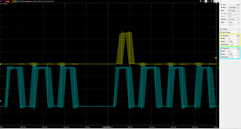

I am working with MPC5644A/SPC5644A MCU and the spark function of NXP's engine control library. The problem is that, I can not maintain the spark end angle and dwell time correctly (as below, I am expecting a zero value spark end angle). Are these effects normal or something is wrong in spark function of NXP's engine control library ? Would you please share your suggestion for that problem?

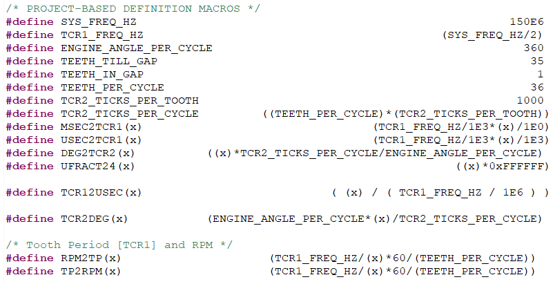

I am building sw for 2-stroke engine (thus engine cycle is 360 degree) with 35-1 crank teeth. My engine system configuration is as below;

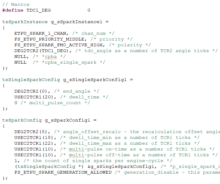

API configuration for spark function is as below (I am not using multi pulses);
I also checked the pre-compiled etpu set in the new etpu function selector utility as below, and the effect was the same.

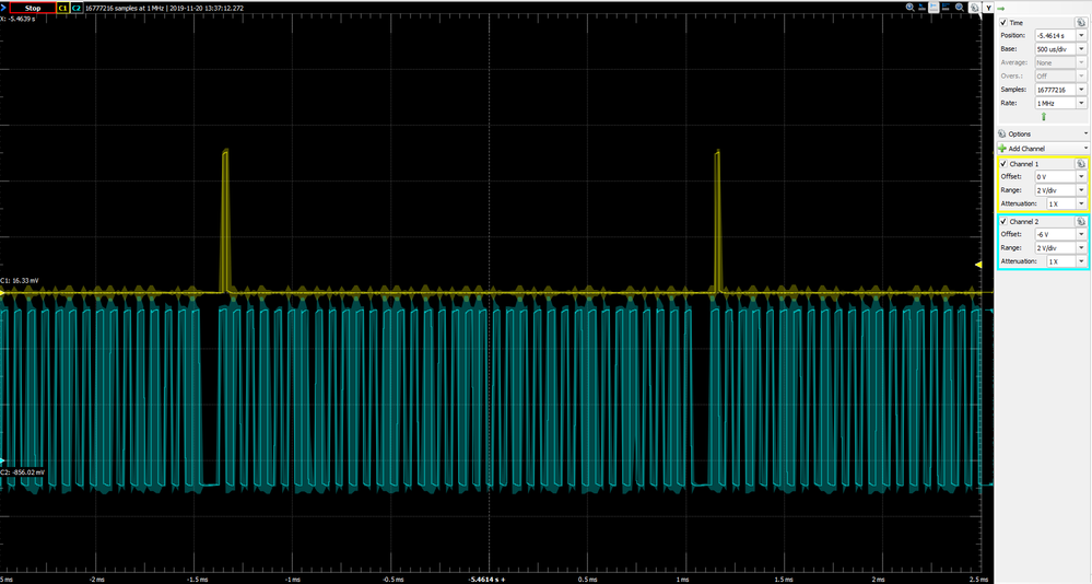

Outputs for crank (in green) and spark (in yellow) signals are as below;

Thank you for your help. I checked your suggestion its correct with a minor mistake. Positive values precede the TDC, negative go after TDC, therefore -340 or 20 degree end angle sets correct. My mistake was that I was testing the crank and spark functions with very high RPM value (ex. 40000). When I checked the software with the real upper limit RPM, the spark output is fine as I expected. Thank you again for your help.
tsSingleSparkConfig g_sSingleSparkConfig1 =
DEG2TRC2(20), //spark end angle: positive values precede the TDC, negative go after TDC
Turgay

Hi Turgay,
I think problem is about setting end angle. Last teeth before gap is not equal to ange of 0. Angle of this point is 360/36 *34 = 340.
Angle of 0 is first falling edge after gap. You can see this at https://www.nxp.com/docs/en/application-note/AN4907.pdf  document on page 5.
If you change spark configuration as
DEG2TRC2(340), //end angle
Problem will solve. Spark will work as you expected.
