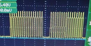

Hi, davidtosenovjan:
       I refer to your advice to config DSPI(CONT = 1).Now,
the PCS signal remains asserted for the duration of the two transfers.
;But SCK signal inserted Tcsc and Tasc.

Hi davidtosenovjan:
        I refer to the example you provided to write the following code,but it didn't work.I have no idea to modify.Are there any advice you can provided.
