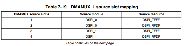

Picture1 show the relationship which PIT you should use when configure the DMA channel in periodic triggering mode
if i choose the DMA 16  channel , and choose the DMAMUX_1 source 3 , then which PIT channel i should configure as a periodic trigger?
DMAMUX_1.CHCFG[0].R = 0xC3;// enable periodic triggering mode  ,i think PIT channel 0 or 2?

could you please specify microcontroller you use? I need to check reference manual to tell you correct answer.

im using the micrcontroller MPC5744!

if you use DMA_MUX in trigger mode, please ignore table 7-18 and 7-19 and see only table 7-17.
As soon as you have configured DMA_MUX in trigger mode, you can select source 0-3. If you select source 0, PIT channel 0 is used to trigger DMA channel and so on.
So, in your case, if you choose source 3, from my point of view PIT channel 3 will be used.

1. perhaps your undersatanding of the  PIT channel is not right,
cos there is no 0 source ,DMAMUX source slot count from 1  from the table 7-19
         0 means DMAMUX channel trigger,  corresponding PIT channel 0
         e.g DMAMUX_1.CHCFG[0].R = 0xC3  this is  0 channel ,should be triggered by PIT 0 ,in desipte of which source you choose.
          but the question is it is still useless when i finished to configure the PIT channel 0 , so im confused?

I am sorry for my previous answer. It seems that things are little bit different.
For triggering, only DMA channels 0,1,2 and 3 can be used. So, you can use only DMA_MUX_0 CHCFG0 - CHCFG3. Source must be set to 24 - 29.
DMA channel 0 is connected with PIT channel 0, DMA channel 1 is connected to PIT channel 1 and so on.
I can see my colleague sent you answer in the thread below:
https://community.nxp.com/thread/504935
