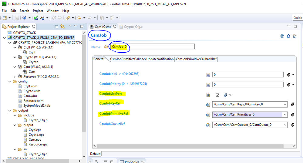

1) Hi Team NXP,
We need your answer for the following query:
[Query] Is the second param that needs to be passed for below API i.e Job Configuration Structure shall be auto-generated by EB_Tresos configuration or it needs to be defined manually by Developer using type: Crypto_JobType
--->            [API] : Crypto_ProcessJob ( uint32 objectId, Crypto_JobType*  job);
[Context] For a CSM Stack : (CSM, Cry-If, Crypto) configured using MCAL4.3_CRYPTO_P1, to achieve Job Processing for SYNC_AES_ENCRYPT_AND_DECRYPT, the JOB_CONFIGURATION_STRUCTURE is not generated.
[Explanation] The following image shows the CSM_JOB_CONFIG_INSTANCE which is expected to generate a CONFIG_STRUCTURE post generation but is found missing in : 'Crypto_Cfg.c', 'Crypto_Cfg.h'.
[Query] So, with ref to above image, Can I expect a 'JOB_CONFIG_STRUCTURE' to get generated in 'Crypto_Cfg.c' file as per above config and references given in it for Keys and Cry_Primitives ?
- If not a job is generated of type 'Crypto_JobType Job' based on the configuration already made in tool, do developer need to manually update the structure and pass it to below API.
- Also, please let me know on next CRYPTO_MCAL_Plugins update if possible which might address this issue. :smileyhappy:
- Request you to respond ASAP :smileyhappy:
Thanks in advance for understanding our need.

My understanding here is JOB_CONFIGURATION_STRUCTURE, which is in responsible of Csm, cannot be a part generated by Crypto, i.e., appears in Crypto_Cfg.c and Crypto_Cfg.h. As Csm is a stub in MCAL's perspective, it is also not generated by NXP Csm itself. So developers need to manually update the structure and passing it to Crypto_ProcessJob

lakshmikanth
Hi Nam Nguyen,
Thanks for the response
I take the inference that developer needs to update the structure. (I'm going as per that).
One last query : Do you expect it to be  auto generated in next 'CRYPTO MCAL PLUGINS RELEASE' ? (is should be possible I guess, as all details need for job configuration are statically configured by developer and hence available).
Anyway, I'm updating manually now. If possible please respond to above query.

As far as I know, I don't expect that the Job configuration structure is auto generated in future Crypto release, since CSM is (at least for now) always a stub and only aim to avoid compile error. With CSM package provided by other integrator (Vector DaVinci, for example), I assumed that Job configuration structure is auto generated, but anyway you should contact to provider for better usage.
