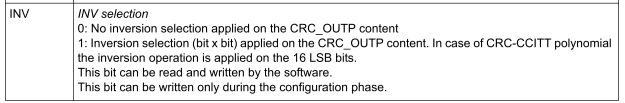

I do not have such code but from my experience, you should enable inversion (INV bit in CRC_CFG). My tests show that then I'm getting the same result as some online CRC32 calculators available on web. I believe that some of the algorithms you already tested will work.
Lukas

If you don't change the configuration as mentioned, it does not return 'standard' CRC32. If you can't change the configuration, you need to update the code to follow this difference:
I do not have such code.
Lukas
