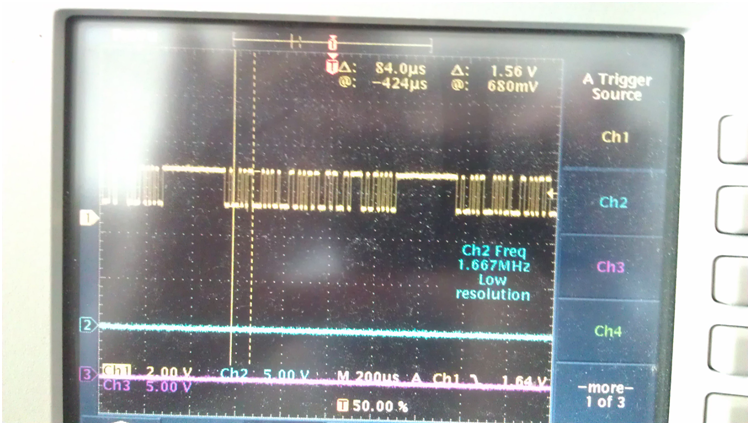

I use Busmaster and an ETAS es581.2 to see, if the CAN-Interfaces works, but nothing happens. Also on the oscilloscope shows no activity on CAN-High or CAN-Low.

With the mentioned example measure also the CAN TX/RX lines on CAN-Enable jumpers with the scope.

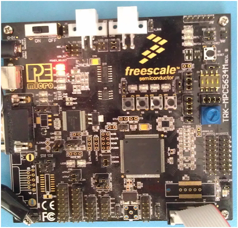

PetrS
I meant FlexCAN ESR/ECR registers. You can display them once you select it via REG button, or you can add Registers details into Variable window, see below.
I have downloaded the example and test it on my TRK board, it works well. I see the Can message on JP3 port. Check jumpers from picture.
Note: as the message is not acknowledged it is repeated still and you get the ACK error in ESR register. Also the TX error counter in the ECR register shows value 128, which means the FlexCAN is in error passive mode.
Petr

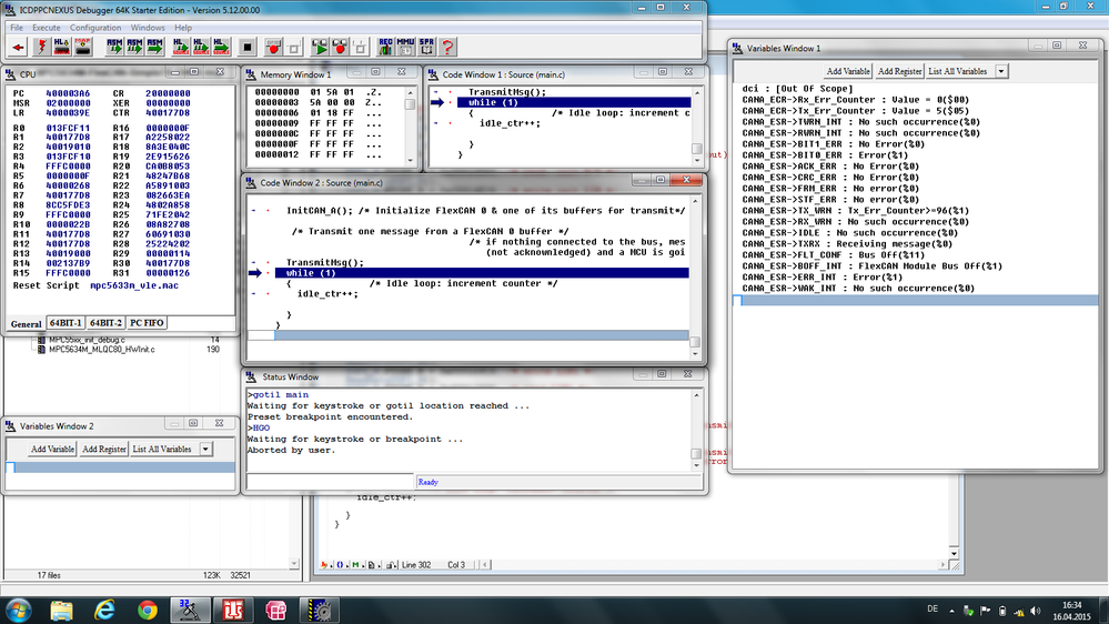

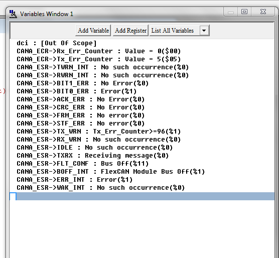

markust
The Jumper are set completly like yours.
But I get these results in the ECR/ES:
What could it be?
3,314 Views
PetrS
you got the Bit error and you are entering the Bus off state. This is most probably if you are not receiving what is transmitted. This could happen due to
- RX pin is not properly initialized
- SBC is not properly initialized
- if anything else is connected on the bus and baudrates do not match
In case nothing is connected to the bus, you should not get Bit errors, assuming RX/TX pins and SBC are initialized properly. In this case you get ACK error.
