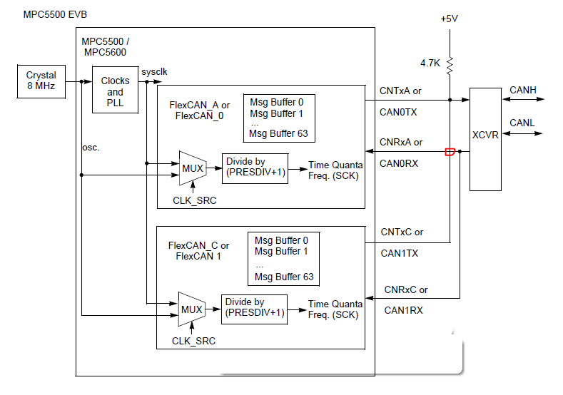

senthilcoramuta
Hello Markus,
For me also, I faced the problem in working with CAN, initially and the program and suggestions given by Petr worked. Thanks for his support.
I would add one more suggestion to you.
Why dont you test the example code in the examples folder of your freescale installation first.
c:\Program Files\Freescale\CW for MPC55xx and MPC56xx 2.10\(CodeWarrior_Examples)\563xM-CW\Flexcan
This code can be used to test your can pins (can tx, rx) from the controller end (and not the transceiver output). You need to short the tx and rx pins of the can tx, rx lines and connect a pullup resistor as shown in the below circuit. (the red circle drawn is a short point, in cookbook they have made a small mistake). This example code is a loopback test and you get more information in the cookbook.
