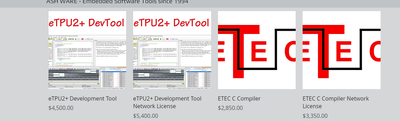

EmilyZhou8
I am wondering if I want to generate "auto.h" file for function application and edit "set.h" file, should buy both eTPU2+ Development Tool and ETEC C Compiler? And I also want to know the differenec between with and without network licence.

mc6808
The eTPU2+ is bacwards compatible so you can use existing tools, but unless the bytecraft compiler has improved radically it was not really compatible with any eTPU: the version I used was full of bugs.
