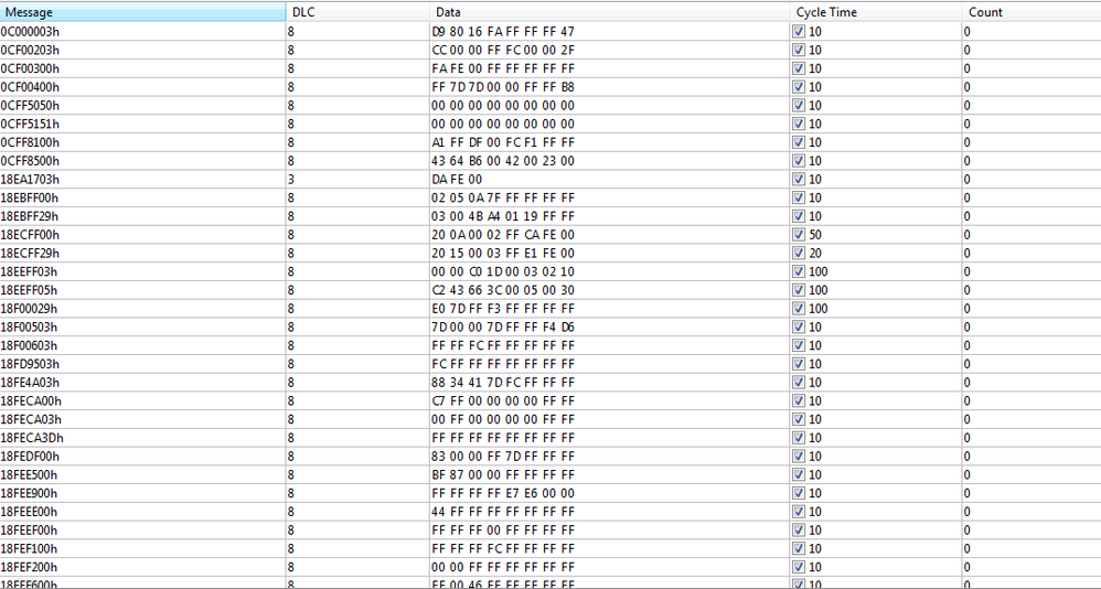

Hi. I am using MPC5644A
I want to update a Firmware using BAM(eSCI).
But When i am receiving CAN_A message continually, I can;t update
For example, I receive CAN message like Figure. 1
There is no BAM echo message (0xFEEDFACE)
and When CAN_L, CAN_H pin are short, BAM works well
I can't understand that CAN_A message'ID I recieved is not 0x00, 0x01, 0x02, 0x03, 0x11, 0x12, 0x13
Help me please

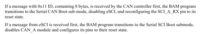

Well, then it makes sense. There shouldn't be any traffic on CAN_A because (copied from reference manual):

lukaszadrapa

lukaszadrapa
Yes, but there can't appear a message with 0x11 ID:

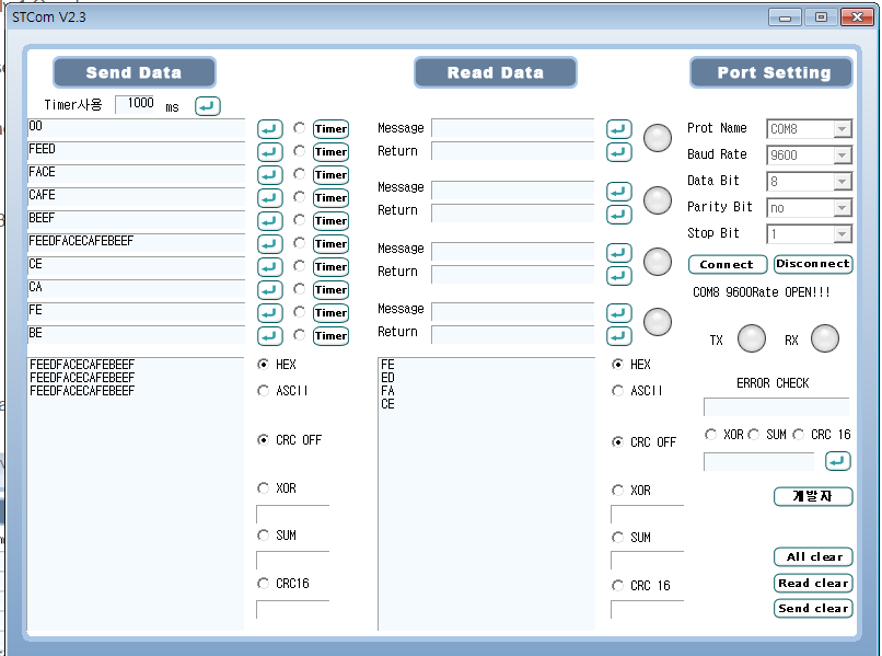

youngguekim
Thank you very much
I have only 1 Question.
when I use Fixed Baud rate (9600bps, crystal frequency : 8MHz),  I can't receive echo message(0xCAFEBEEF)
do you know what is problem??
1. Fixed Baud rate
2. Baud rate Detection (Nomal)
7,149 Views
lukaszadrapa
Is a delay between characters long enough? We can't send next character to device until BAM finishes transmission of echo character. If the baud rate is 9600 bps, 10 bits (start bit + 8 data bits + stop bit) are transmitted in 1.04ms. If we add some time for software overhead, the delay between characters should be about 1.1ms or 1.2ms, at least. Could you check that?
It doesn't explain why it works when baud rate detection is used but I can't see other reason.

youngguekim
Delay between characters is long enough (above 0.5s)
it's better to use Detection mode.
Thank you for your help. Lukas Zadrapa
1. Fixed
2. Detection

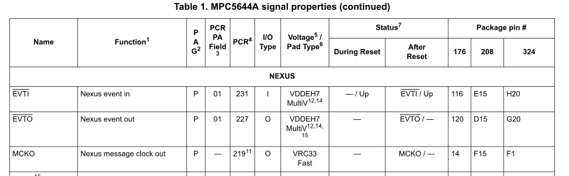

lukaszadrapa
Yes, I have 8MHz crystal.
Have you pulled EVTO pin up? You can use 5-10kohm resistor.
I tried to pull it down for test purposes and I can see that BAM returns only FEEDFACE in this case. So, this could be the reason.

youngguekim
when I use Fixed mode, EVTO pin -> OPEN
when I use Detection mode, EVTO pin -> Short
you mean, When I use Fixed mode, I have pulled EVTO pin up (5~10kohm)?
I will try..
7,149 Views
lukaszadrapa
EVTO is not pulled up internally:
So, you have to pulled it up by external resistor...
