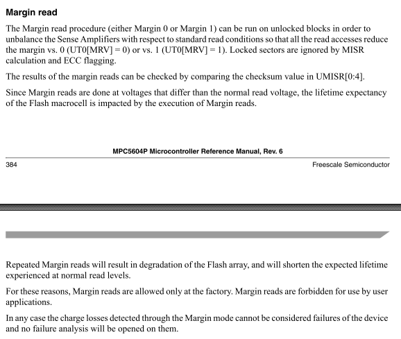

Also it is mentioned that sequential sequence is particularly used for margin mode. What actually Margin Mode is?

- What will happen, if I do perform Array Integrity from the same block? Will there be any mismatch ?
- It leads to RWE error.
- What actually Margin Mode is?
- In short - the voltage threshold for flash reading is slightly changed either up or down (can be set by MRV bit). That means you can confirm if the flash cells are erased enough or programmed enough.
Lukas
