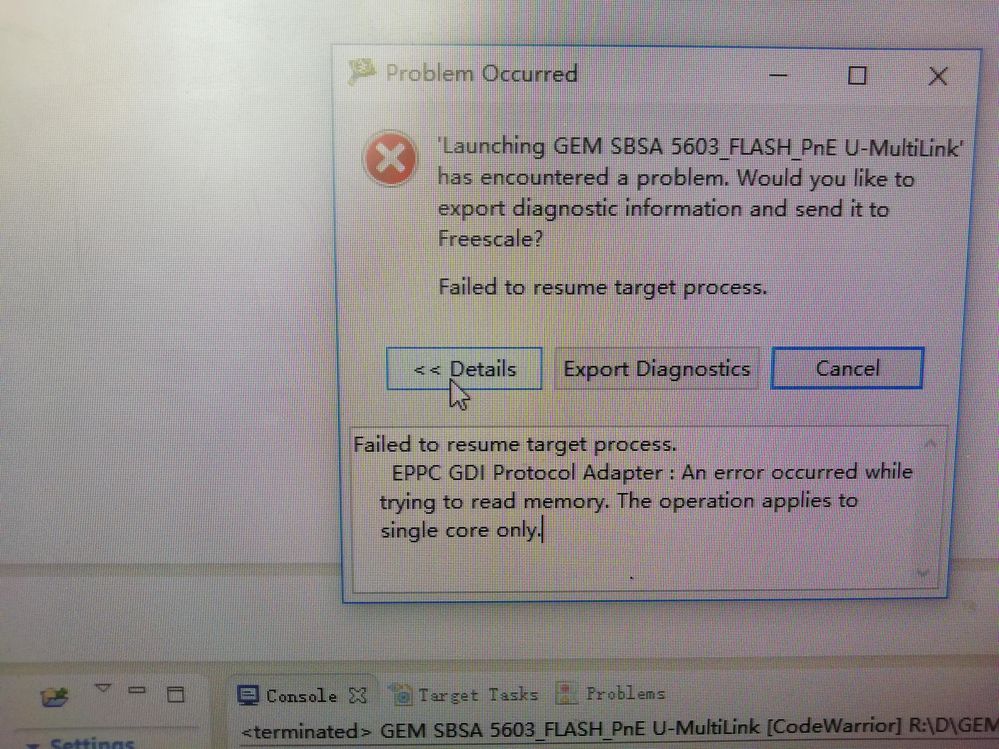

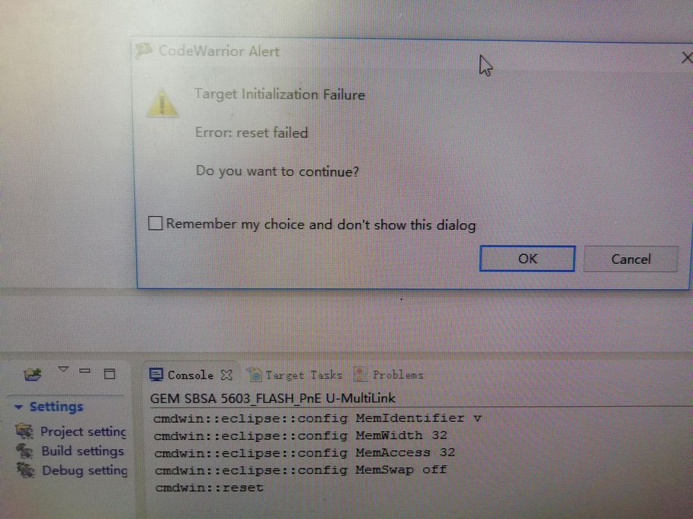

My client uses the SPC5603B to configure the CensorShip and configure it according to the configuration file provided by the Community. After the configuration is successful, the correct password is entered, the connection cannot be made, the program cannot be downloaded, and the error in the picture is displayed. Customers doing the same thing on CodeWarrior 2.1 and CodeWarrior 10.6 IDEs are not successful.Could you help me to see what the problem is?Censorship1.jpgCensorship2.jpgCensorship3.jpg

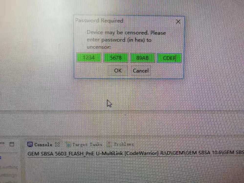

Hi, for this I have example code here:
Example MPC5604B Censorship CW210
Looking to your description, you apparently omitted censorship password must be entered in reverse oreder i.e. in you case 0x89ABCDEF12345678
Hope it helps

Thanks for your reply.The customer tried to enter the password in reverse order, but the same error occurred before.The figure is the interface where the customer password is set successfully.微信图片_20190326100545.jpg

I don't see any obvious error. Have they tried my example codes?
