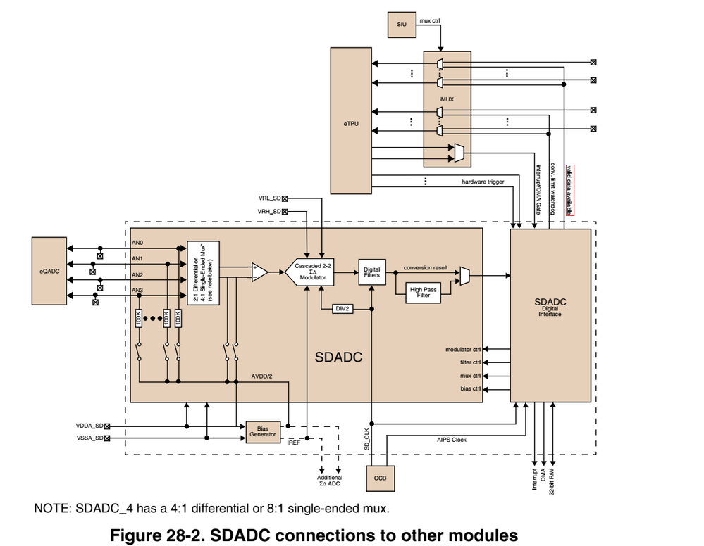

Hello David,
As I know, the input of ETPU channel can be connected from the SDADC valid data flag output or the external pad, we use the SIU_SDETPUA, SIU_SDETPUB, SIU_SDETPUC to choose the connection .You can see the below image:
- I use ETPUA channel 9:
      + In the case 1, ETPUA_9 is connected to the external pad, the pinstate returned by fs_etpu_gpio_pin_history is correct as expected.
      + In the case 2,  ETPUA_9 is connected to the SDADC1 data valid flag output, the pinstate returned by fs_etpu_gpio_pin_history always be 0 even though the SDADC1 Conversion Data Valid Event is enabled(CDVEE bit of SDADC_RSER is 1) and Converted Data Valid Flag is 1(CDVF bit of SDADC_SFR is 1). This is wrong. I don't know why.
- The difference between these 2 cases is just SIU_SDETPUA configuraion.
Do you know why?
Tam
Sorry, the ETPU channel is ETPUA_15
I tried with 2 cases:
- The ETPUA_15 channel with SDADC2
- The ETPUA_9 channel with SDADC1.
The pinstate always be 0.
