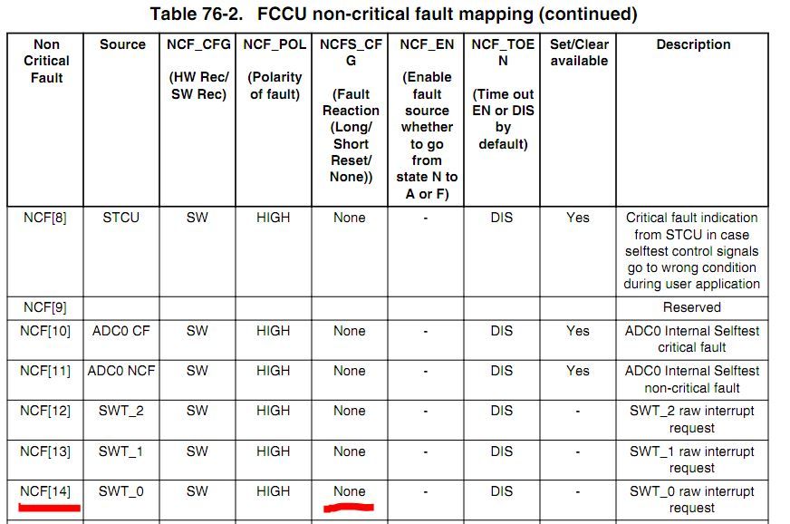

Hello Peter,
I have implemented SWT0 on SPC5748G with this example code, but I have a question about FCCU initialization.
According to the SPC5748G RM, it describes that NCF[14] fault reaction is "None".
What is the exact meaning about this?
SWT0 of SPC5748G can report directly to the RGM without FCCU?
Neo
According to table reaction is None.
SWT is not directly wired to RGM module.
SWT timeout is wired to FCCU and FCCU is connected to RGM.
You have to configure FCCU in order to react on event coming form SWT.
Peter

The problem now is that when Long RESET, it stops at the
;# Fill SRAM with writes of 32GPRs
sram_loop:
e_stmw r0,0(r5) # Write all 32 registers to SRAM
e_addi r5,r5,128 # Increment the RAM pointer to next 128bytes
e_bdnz sram_loop # Loop for all of SRAM
Long RESET is not RESET to _start?
