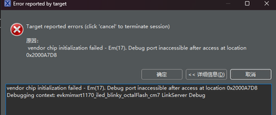

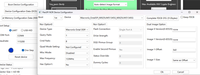

hi, all
I tried following the instructions below to use the demo board's octal flash
https://community.nxp.com/t5/i-MX-RT-Knowledge-Base/RT1170-Octal-flash-enablement/ta-p/1498369
as 3.2 this process also seems to be correct.
and I used the program "evkmimxrt1170_iled_blinky_octalFlash_cm7" in the attachment.
but something is wrong

Flash Driver V.2 startup failed - rc Em(17). Debug port inaccessible after access at location 0x2000A7D8
chip initialization failed - Em(17). Debug port inaccessible after access at location 0x2000A7D8
failed to initialize flash driver MIMXRT1170_SFDP_MXIC_OPI.cfx
request to clear DAP error failed - status 5
error closing down debug session - Nn(05). Wire ACK Fault in DAP access

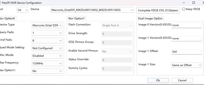

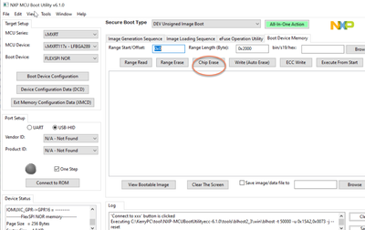

 1. In the MCUbootutility, use mass erase at first
2. your app
What's the app you are using?
You need to make sure your APP FCB is the octal flash, do you use my attached project in my document?
Please help to check it.
Don't worry, I have tested all of it previously, and it works in the previous time, if you still have issue, I will help you to test it on my side again.
Kerry

pupu_ji
Thank you for your reply!
I already modify the hardware from QSPI flash to octal flash.

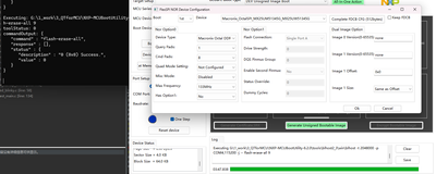

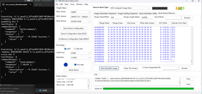

If I use this tool to download the octal flash program , choose octalspi mx25um51345g, and the lights on the demo board can blink, can I consider that the hardware has been modified correctly?
But when I use IDE to try to download the project from the attachment and select the octal cfg file, it fails.
Could you please help provide a direction to solve the problem?? Thank you.

kerryzhou
Hi @pupu_ji ,

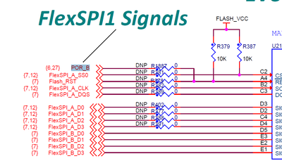

  1. Hardware, MIMXRT1170-EVK board
  Please check R378, R412 is solder.
Please also make sure, J5,J6,J7,J8 is insert
  2. In your MCUBootutility, do the mass erase at first.
  3. your use MIMXRT1170_SFDP_MXIC_OPI.cfx is in the IDE:
C:\nxp\MCUXpressoIDE_11.9.0_2144\ide\LinkServer\binaries\Flash
Right?
Do you mean, you use the default IDE .cfx is not OK?
Your debugger is CMSIS DAP or JLINK?
.cfx is for the CMSIS DAP, JLINK is need to use the RT-UFL.
Kerry

"2. In your MCUBootutility, do the mass erase at first."
ok, I do this ><

pupu_ji
hi,
I found the cause of the error and soldered the R1887 in the schematic. And the project was also successful using your example. Thank you very much for your support!
3,473 Views
kerryzhou
Hi @pupu_ji ,
   Thanks so much for your effort and the updated information.
  You mean, your board also solder the R1887 which should DP, right?
  You soldered the R1887 in mistake, right?
Kerry
3,467 Views
pupu_ji
Yes, I soldered the R1887 by mistake.><

kerryzhou
Hi @pupu_ji ,
  That's reasonable.
   As then, if do the flash reset, it will even reset the POR, then the RT chip will also be powered, that's why all the chip debugger connection lost.
  Anyway, it's OK now, just enjoy it.

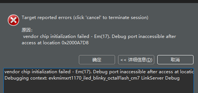

pupu_ji
Yes,I used the attached project in your document !
And I've followed the documentation but it still fails.
Maybe I'm just careless and made a mistake, but I have no idea.
Following your guidance, it still faild...
The error is caused by " vendor chip initialization failed"?
Is this a hardware failure?
log is following

Failed to read address register in DAP - Nn(05). Wire ACK Fault in DAP access
flash driver polled mailbox (8 bytes at 0x2000A7D8) read failed (on poll 1/301) - halting for postmortem - rc Em(17). Debug port inaccessible after access at location 0x2000A7D8
failed to halt target for postmortem - rc Nn(05). Wire ACK Fault in DAP access
failed to read registers - Nn(05). Wire ACK Fault in DAP access
