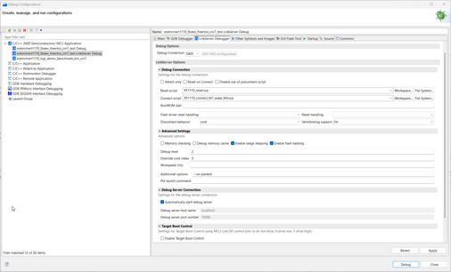

I have MIMXRT1170 EVK  board.
Using MCUxpress IDE, imported the SDK, in SDK have ran  the hello world and led blinky example projects which is available, working fine build, flash and debug.
same thing in SDK selected the existing example for display
this memory configs are not modified used the existing only,
here able to build and able to flash,
Here issue is when i do debug i am facing bus fault errors and hard fault error, as you can see in image
Can someone suggest any memory configs need to do, any debug configurations need to modify

Hi @srihari ,
Thanks for your interest in NXP MIMXRT series!
Could you provide me with some more information?
The SDK version number and the IDE version number. Also, are you using the on-board debugger? Are you using CMSIS-DAP firmware? What is the EVK board power supply configuration?
This information will help me try to reproduce and diagnose the issue on my end. Thanks in advance!

Hi @Gavin_Jia,
Issue is resolved,
Actually i am using MIMXRT1170-EVKB board but, the SDK I have downloaded for SDK_26.03.00_MIMXRT1170-EVK , it suppose to be SDK_26.03.00_MIMXRT1170-EVKB After downloading the correct SDK, I have executed the display examples, it is working fine
