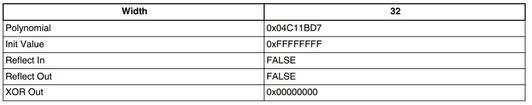

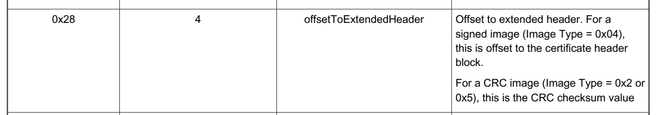

I have an image built using the MCUXpresso Secure Provisioning Tool.
It's a plain image with a CRC,
and the offsetToExtendedHeader field(address 0x00000028) contains the 4bytes CRC checksum value.
Now, I want to check the CRC before writing it to flash.
I tried to calculate it using these settings,
but I cannot match the CRC with the offsetToExtendedHeader field.
(ref: Kinetis Bootloader v2.0.0 Reference Manual)
Is there any tool available to calculate the image CRC (like nxpimage and blhost)? Alternatively, where can I find more details about calculate the image CRC?

Hi Victor,
SEC tool uses SPSDK application nxpimage to build a CRC bootable image. You can see generated build script to find, how the nxpimage tool is used.
See main menu > Help > SPSDK Online Documentation for nxpimage documentation.
SPSDK is opensource, so you can find implementation details in GitHub.

victorchiou
Hi Marek
I found the Mbi_ExportMixinCrcSign function
and the CRC algorithm in the nxpimage tool, which is part of SPSDK.
Based on the above algorithm,
I created a python program to verify the image CRC,
and it works.
Thanks for your support.
