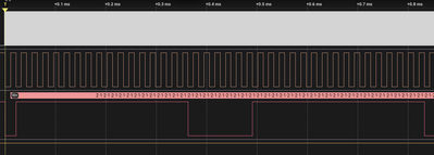

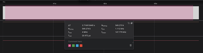

Hi, I'm trying to make I2S work on FRDM-MCXC444 through configuring it with MCUXpresso Config Tools, but I've encountered a couple of problems:
1. Using DMA with callback, there is some empty buffer sent before callback is called.
(top - BCLK; middle - WSCLK; bottom - data(32 packages filled with ones). Callback repeats the same transaction using the same buffer. Expected behavior - WSCLK is 1 after transaction is over, much smaller delay before callback)
2. Setting the target frequencies does not work.
Encountered scenarios:
MCLK is fed from System clock(12MHz), target frequency set to 3.072 MHz(Config Tools says this frequency will be created using fractional frequency divider).
BCLK is set to replicate MCLK, 3.072MHz to meet sampling frequency of 48kHz with word width 32 bits.
This configuration produces this result:
(BCLK ~23.437kHz)
(MCLK ~3.989MHz)
I couldn't find any explanation for given behavior apart from speculation around "overloading" the fractional divider with such precise target frequency. Still, configuration tool doesn't inform about anything happening with clocks.

Qual
I'm sorry for not providing more information in my post.
I'm using MCXC444 as master to send information to external DAC(PCM5102A), which supports different clock frequencies and generating MCLK on it's own, what allows me to use 3-wire connection. I'm targeting setup with fs=48kHz, BCLK=3.072MHz and word width of 32 bits. Because of this setup, the MCLK is used only to feed the BCLK.
The project I'm testing with is attached to this reply.

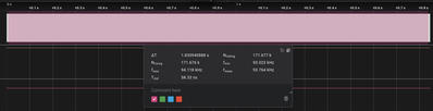

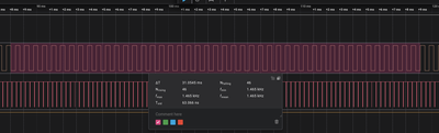

Here are results captured by my logic analyzer:
MCLK:
BCLK:
FS and TX:
Screenshots are separated because simultaneous connection resulted in jittering and very inconsistent waveforms. I'm not sure if this is a product of my logic analyzer or MCU. Still, the captured frequencies do not match one's configured through config tool.
Results are better when BCLK is generated not by MCLK, but through other clock and prescaler. Sadly, this arrangement doesn't allow to match needed frequency with enough precision.

Hello again @Qual ,

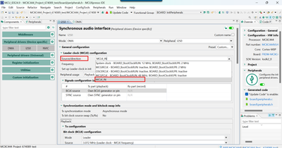

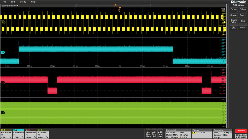

Sorry for taking a while to get back to you. I truly appreciate your providing me with more detailed information. Referring to your Mex configuration, I have also conducted some tests. Since I don't have the PCM5102A module on my side, I could only briefly examine the waveform of I2S. As shown in the figure below, I deem it to be okay. Note that from top to bottom are BCLK, FS, TXD, and MCLK in sequence.
I have reviewed your code and Mex configuration. In my opinion, there is an issue with the selection of MCLK. You stated that MCLK is sourced from the external DAC (PCM5102A). Therefore, according to "5.7.10 I2S/SAI clocking" in the RM, the MCLK Source should be set as MCLK_in instead of the System Clock.
About more configurations regarding the I2S master, you can refer to "39.5.6 I2S Master" in the RM.
