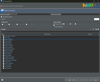

tried to get a reference project using the Trustzone of my RFDM MCX N947. Used the MCUXpresso SDK Builder to build the SDK for the board and installed it in MCUXpresso IDE. When trying to import SDK example there is no Trustzone example available.
Found the following guide, built and downloaded SDK for the lpcxpresso55s16 but still no Trustzone examples available in the import wizard
https://mcuxpresso.nxp.com/mcuxsdk/latest/html/boards/LPC/lpcxpresso55s16/gettingStarted/topics/buil...
I found the examples in the Examples Tab of the MCUXpresso SDK Builder but if selecting the examples, the SDK can not be built with the MCUXpresso toolchain anymore, only ARM GCC/MCUXpresso for VS Code.
Are those examples still available for the MCUXpresso toolchain?

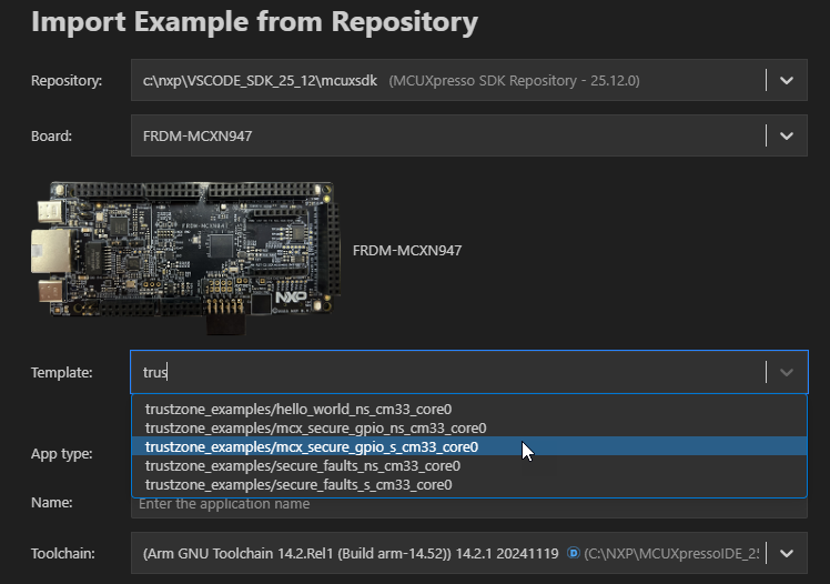

There is no specific TrustZone example in MCUXpresso, but it is used in other examples. For instance, in the TFM examples, which use the trustzone architecture to create Trusted Firmware. For more details about TFM, please refer to this page.
Another example that uses TrustZone is the multicore example rpmsg_lite_pingpong_tzm, as mentioned in its README file.
However, in the MCUXpresso extension for VS Code, there are examples demonstrating TrustZone that can be used as a reference, as shown in the following image:
There is also a training available that explains how to Develop Secure TrustZone Applications | NXP Semiconductors, which may be helpful.

I saw the multicore example rpmsg_lite_pingpong_tzm later on and that works for me.
I already tested the VS code examples but those are not that helpful regarding memory configuration but thats another issue.
