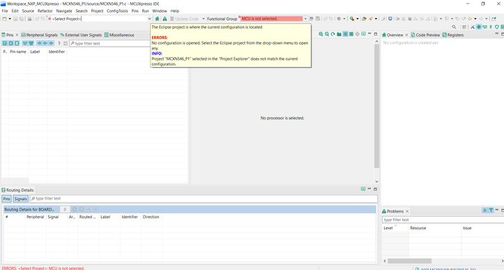

Later I tried to include SDK for MCXN546V zip file from the dashboard and dragged and dropped, but still I am facing error in added the zip and after adding getting error in clocks, pins configurations. I attached the shreenshot with this post. Please share any example project with MCXN546V pin, clock configurations for uart test.clock_config err.pngclock_config err.png

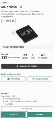

Hello @Elakiya,
The error occurs because the SDK was generated using the ARMGCC option. This option is intended specifically for use with MCUXpresso IDE for VS Code.
If you plan to use MCUXpresso IDE, you must instead choose “Other” and then select MCUXpresso IDE, as shown in the image below:
Once you download the correct SDK, simply drag and drop the file into the “Installed SDKs” view inside MCUXpresso IDE to install it.
You can also download SDKs by following the steps mentioned in this post. Even though the example is for the RT1060, the process is exactly the same for the MCXN546.
For help with Config Tools, there is a User Guide available on this page, which may be helpful.
If you have any further questions, do not hesitate to let me know.

Hello, @Habib_MS, Thanks for your response, I have tried to include the proper SDK download for MCUXpresso IDE from the NXP dashboard "other" option. But after freshly reinstalling MCXN546 sdk file, and creating the project, the pin, clock configuration are not opening, I am facing issue with configuration which is shown in screen shot. If anyone have MCXN546V chip SDK for custom PCB chip with MCUXpresso IDE,

Hello @Elakiya,
The issue is caused by incorrect information stored in SDK package new project template, specifically in the file called "clock_config.c", there is incorrect ID of the package:
To work around the issue, in SDK package you downloaded please set package_id as is shown in the file called "pin_mux.c":
Making this change I am able to use config tools for MCXN546.
If you experience any issue, do not hesitate to let me know.
Habib.

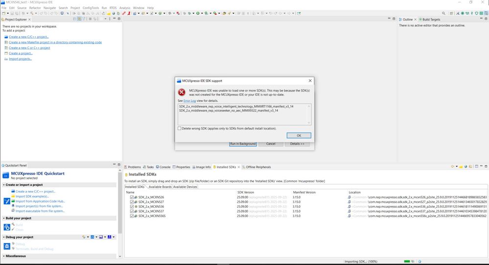

Elakiya
When I try to add MCXN546 SDK zip to MCUXpresso IDE , I get this error, why?  sdk_error.JPGsdk_error.JPG
The added SDK zip file is properly downloaded from the NXP dashboard, but still why this issue?sdk_dwnld.JPGsdk_dwnld.JPG
Please guide to solve this issue
