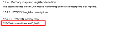

In MCXNX4XRM Rev. 4, the SYSCON0 base address is 4000_0000h
However, in mcux-sdk, the address is 0x50000000.
Which one is correct?

I see, in 0x4000_0000 is non-secure, while 0x5000_0000 is secure.
