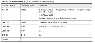

Hello @victorchiou
All the two bootloaders inside. UART-isp and USB-isp.
Depending on the values of ISP mode in the CMPA and ISP pin, bootloader decides whether to enter normal boot flow, or enter  which ISP mode.
By default, these bits are 000. So if you want to enter ISP mode, just pll-down ISPMODE_N P3_29. The first valid probe message on UART or USB will be used.
Alice
