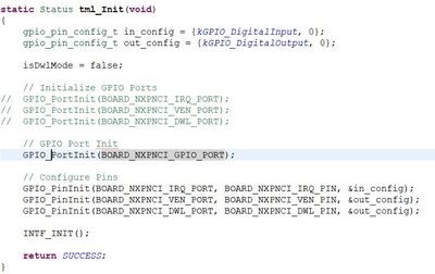

8,593件の閲覧回数
RomanVR
Hello @S_Salam555.
From the changes you have done to the project I have noticed that you are missing to initialize the IRQ, VEN and DWL pins, please do so just as you have done it for the SPI pins and make sure that the initialization is consistent with the GPIOs configured in the TML.
Additionally, please confirm if now you are able to see SPI frames in the corresponding terminals, preferably with a logic analyzer.
Best Regards!

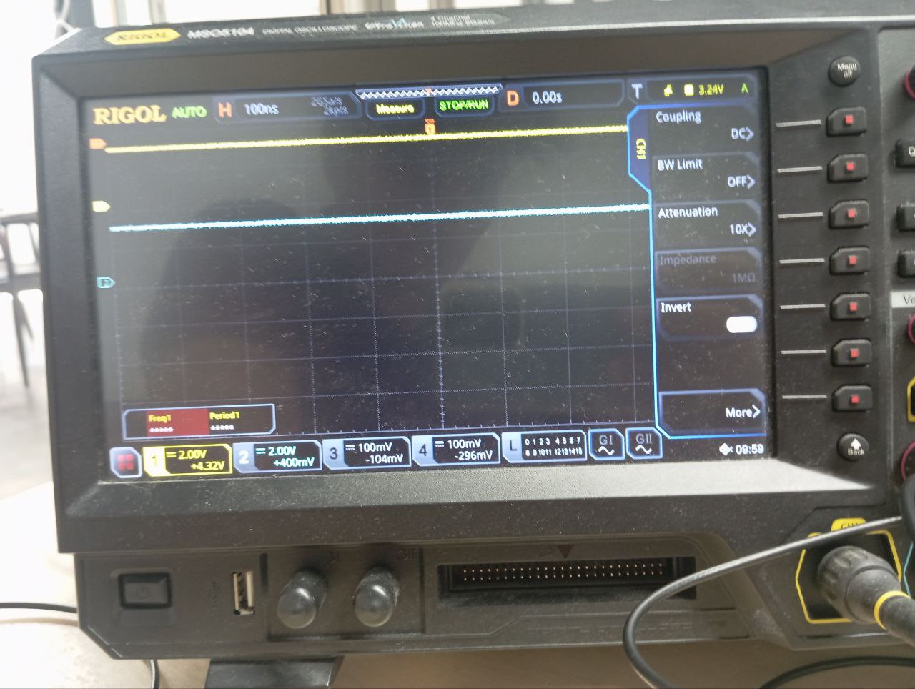

9,492件の閲覧回数
S_Salam555
Thank you for your suggestion.
I have already based my implementation on the SPI examples available in the MCXW SDK, ensuring that the clock initialization, pin muxing, and configuration parameters are aligned with the reference design.
As requested, I have shared the SPI communication waveform along with the complete project folder for your review.
Please let me know your findings or if any additional information is required.
Shakir Salam
9,437件の閲覧回数
RomanVR
Hello @S_Salam555.
Please check that the SPI and GPIO instances and pins initialized match the ones used in your TML.
Also, avoid enabling more than once the clocks of the peripherals and ensure to be properly clocking all of the used ports required by the pins used to communicate with the PN7160.
Regarding your SPI communication capture, is the MCXW71 not sending any SPI frame?
Best Regards!

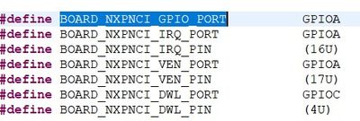

8,575件の閲覧回数
S_Salam555
Hi Roman,
I hope you're doing well.
It appears there are differences between the PC55S6X and MCXW71 configurations. The PC55S6X uses four parameters, whereas the MCXW71 only has three. I have already made the necessary adjustments accordingly, but the results remain the same.
Could you please help verify whether the pin and port configurations for IRQ, VEN, and DWL on the MCXW71 are correct? I would also appreciate your guidance or recommendations on the correct pinout for these three signals.
I have attached an image below highlighting the differences between the MCXW71 and LPC55S6X for your reference.
Thank you in advance for your support.

8,566件の閲覧回数
S_Salam555
Hi Roman,
Here some quick update.
I have updated the pin configuration according to the MCXW71 and PN7160 pinout. However, the result remains the same.
Could you please advise if there are any additional checks or recommendations I should consider?
Shakir Salam

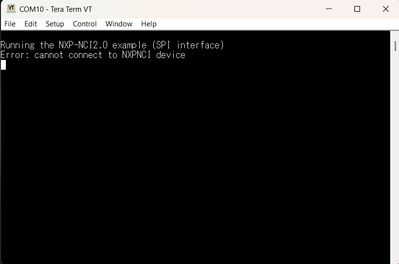

9,678件の閲覧回数
S_Salam555
Hi Roman,
I have conducted tests based on the provided examples; however, it appears that the PN7160 is unable to detect the FRDM-MCXW71. I have included all relevant details in the attachment for your reference. Can you help me double check the hardware wiring as well. thanks.
Shakir Salam
