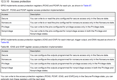

Regarding access protection registers (PCNS, PCNP, ICNS, and ICNP) for the MCX A microcontroller, they are mentioned in the user manual, but not described.
Would it be available a description for these registers?
Thanks!

ZhangJennie
Hello JosG,
Update:
As TrustZone is not present on this device, these registers are not used. We will request to correct RM
Jun Zhang

JosG
OK. Thanks!
