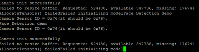

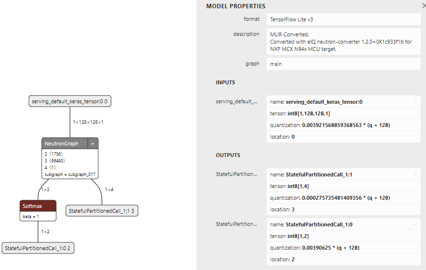

I came across a strange problem. I manually trained a small object detection CNN and successfully created the .tflite file. Then I use the eIQ toolkit to convert it into NPU-supported version (shown below).
We can see that the input and output are in int8, which is great. The total size of this model is just 68KB.
However, when I loaded it to the MCXN947 board, I found that it was bloated up to 512KB!!!
I was using the face detection example (dm-multiple-face-detection-on-mcxn947) from Application Code Hub, with small modifications on the MODEL_GetOpsResolver so that it loads the necessary operations.
Anyone sees this problem before? Did I miss out anything else?

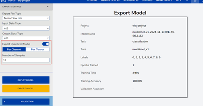

When you export the model, do you select the "Export Quantized Model"?

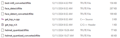

Yes, you can check both the attached file.
helmet_quantized.tflite --> Trained and quantized to 8-bit using python code on my host PC. I did not use the eIQ toolkit to train it.
helmet_quantized_converted.tflite --> This is the converted file using eIQv1.13. I use the eIQ Model Tool to open the helmet_quantized.tflite, then convert to NPU file.
I am using FRDM-MCXN947 board.
No quantization was selected because it was already quantized. You can see that the converted version also have 8-bit input and output. It is only ~67KB in size.
However, when I download the latest face detection demo and replace the original model with my helmet_quantized_converted.tflite , the size is much larger than expected.
*You may try converting my helmet_quantized.tflite, see if you get the same problem.

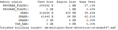

Harry_Zhang
Hi @wklee
This is the compilation size of the face_detect.tflite model.
This is the compilation size of the helmet_quantized_converted1.tflite model.
Hang

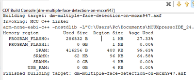

wklee
Dear Hang,
The file size for helmet_quantized_converted is 68KB:
But the compile size becomes 406.5KB, what could be the problem?
There are only ~70K parameters in this model.
Thanks.

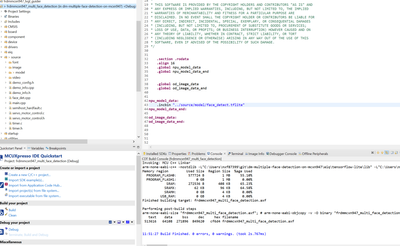

Harry_Zhang
Hi @wklee

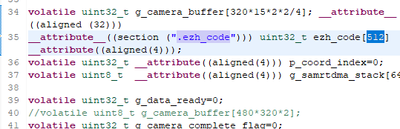

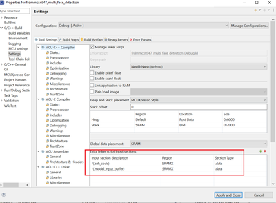

You can check the liker script.
It includes the *(.ezh_code) and *(.model_input_buffer).
So the compile size becomes 406.5KB.
Harry
10,030件の閲覧回数

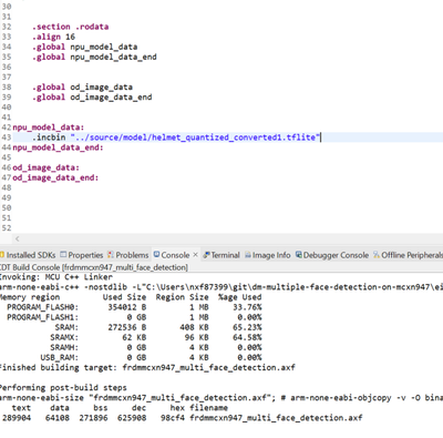

wklee
I don't think that's the reason.
The ezh_code is very small, only 512*4=2KB.
I verify this point by checking the original compilation:
Then modify the ezh_code to only ezh_code[2], which is 8 bytes.
You can see that the SRAMX region is only changed a little.
I think that the problem should be some problems during the conversion from a trained model to the NPU version. If the trained model is in int8 and contains only 70K parameters, there is no reason for the size to grow up to so big (400KB+).
Thanks.
