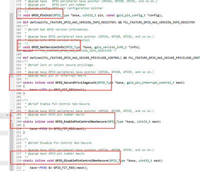

Hello @threeboystech
While the APIs you used not the same with SDK from NXP official.
For gpio, API from NXP SDK like below:
Please download from the link I send to you last time. Thanks.
Alice
