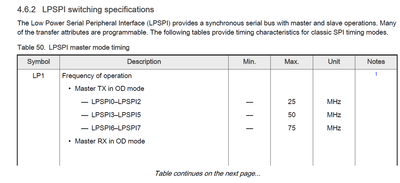

Regarding speed, you can refer to the MCXN236 data sheet chapter 4.6.2.

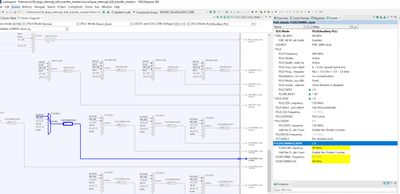

Dear @Harry_Zhang ,
This is my setting. Is it OK?
CLOCK_SetClkDiv(kCLOCK_DivFlexcom3Clk, 1u);
CLOCK_AttachClk(kFRO_HF_DIV_to_FLEXCOMM3);
Thanks.

Harry_Zhang
Hi @seanwu
You can refer to my picture to configure the clock.
After my testing, configuring the clock in this way can meet your requirements.
Harry

Dear @Harry_Zhang ,
Thanks for your help. I try it as your seeting, and it can run 20MHz. But the main  clock will reduce to 120Hz. Does it effect performance?

Harry_Zhang
Hi @seanwu
"But the main  clock will reduce to 120Hz. Does it effect performance?"
I'm just giving you a demonstration, you can adjust the clock according to your needs.
