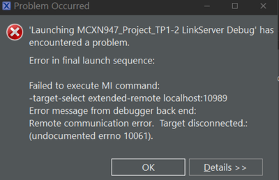

2) During the second lab some of them can't connect anymore to the on-board cpu to download and debug (I suspect that they have updated the firmware, as explained hereunder).
Here are the snapshots when entering the debug mode :

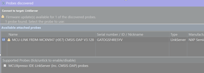

3) I disconnect the student board and connect my fresh new board with success !
(Since our labs, are installed with MCUXpresso IDE v11.9.1, I tried with the latest MCUXpresso without success connecting there boards again.)
My board (working) :

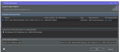

4) From 3) I see a difference between the probe firmware versions :
  • my working board use a MCU-LINK CMSIS-DAP_V3_128
  • the problematic board use a MCU-LINK CMSIS-DAP_V3_153
I tried to reverse the firmware to V3.128 but can't find it on your website.
On NxP site, I only found MCU-LINK_installer_3.140 which allows me to reverse the board to V3_140 but the problem is still the same
Do you know where I can find MCU-LINK_installer_3.128 ?
Is is normal that upgrading the firmware cause such issue ?
Do you have other ideas ?

1) Unfortunatly, reversing successfully (hereunder)  the version to 3.122  didn't resolve the issue.
2) I still get this message when entering download mode  :
(I recall you that my other boards are running correctly on the same computer/MCUxpresso version with CMSIS-DAP V3.128 but can't find it. Anyway, I am wondering if the CMSIS-DAP version is the real issue...)
