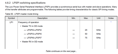

I am using lpspi_interrupt_b2b_master, and lpspi_interrupt_b2b_slave examples in MCXN236 SDK 2.16.00 to test SPI function.
I want to check whether it can run 20MHz. But when I set #define TRANSFER_BAUDRATE to 20000000. The data transfer will be error.
Could you please help to check whether FLEXCOMM SPI can run 20MHz, and how to set?
THanks.

Hi @seanwu
Regarding speed, you can refer to the MCXN236 data sheet chapter 4.6.2.
After you set #define TRANSFER_BAUDRATE to 20000000.
You also need to two factors:
1. Peripheral Clock Configuration: The SPI baud rate is derived from the peripheral clock. Ensure that the peripheral clock is set appropriately to achieve the desired SPI speed.
2. Baud Rate Divisor: The SPI baud rate is determined by dividing the peripheral clock by a specific divisor. Selecting the correct divisor is crucial for achieving the desired baud rate.

Harry_Zhang
Hi @seanwu
You can refer to my picture to configure the clock.
After my testing, configuring the clock in this way can meet your requirements.
Harry
