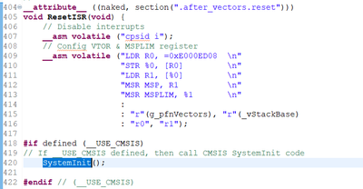

May I double check with you that if  LPCAC is enabled by default in SystemInit(); after reset?

Thanks. The new version of SDK should enable LPCAC in initialization code.

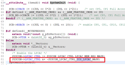

Dear @ZhangJennie ,
In gpio_led_output example, LPCAC is enabled in SystemInit(); So, after reset LPCAC is enabled.
But the performance is not good.

ZhangJennie
Hello seanwu,
When code is running in Flash, enabling LPCAC will improve the performance as same as code is running in RAM. We have measured it with coremark.
However, if your GPIO performance doesn't meet your expectation, normally it's not due to LPCAC, but specific peripheral. We suggest you checking parasitic capacitance on IO pin.  For more information on this topic, please refer and discuss under  https://community.nxp.com/t5/MCX-Microcontrollers/MCXA153-GPIO-rise-fall-time-performance/td-p/19885...

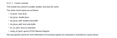

ZhangJennie
Hi seanwu,
The LPCAC is disabled by default. For best performance, NXP recommends enabling it by clearing SYSCON->LPCAC_CTRL[DIS_LPCAC].
When enable LPCAC,  Performance of code running in Flash or FlexSPI Flash matches RAM performance because of LPCAC
This AN includes LPCAC usage. Enable/DIsable LPCAC to test MCX performance.
https://docs.nxp.com/bundle/AN14139/page/topics/mcx_n-series_architecture_overview.html
MCXA153 reference manual also introduces the low power cache controller control method.
You could refer it to test your IO performance. For more about IO performance, please refer your other thread “MCXA153 GPIO rise/fall time performance
