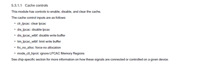

Dear sir,
Is there any document or example of Low Power Cache Controller (LPCAC)?
How to use this feature to add GPIO raise/fall performance?

Dear @ZhangJennie ,
Thanks for your reply.
May I double check with you that if  LPCAC is enabled by default in SystemInit(); after reset?
Thanks.
BR,
Sean Wu
4,094件の閲覧回数
ZhangJennie
Thanks. The new version of SDK should enable LPCAC in initialization code.
You said the performace is not good. Could you specify how did you test the performance? Do you test coremark? are your test on  internal Flash or external?

Dear @ZhangJennie ,
I am using MCXA153 gpio_led_output example in SDK_2_14_2_FRDM-MCXA153, and testing on FRDM-MCXA153. AI add a gpio3_6 to toggle, and measure it's raising time. Default is using internal flash.

Dear @ZhangJennie ,
In gpio_led_output example, LPCAC is enabled in SystemInit(); So, after reset LPCAC is enabled.
But the performance is not good.

Hello seanwu,
When code is running in Flash, enabling LPCAC will improve the performance as same as code is running in RAM. We have measured it with coremark.
However, if your GPIO performance doesn't meet your expectation, normally it's not due to LPCAC, but specific peripheral. We suggest you checking parasitic capacitance on IO pin.  For more information on this topic, please refer and discuss under  https://community.nxp.com/t5/MCX-Microcontrollers/MCXA153-GPIO-rise-fall-time-performance/td-p/19885...

Hi seanwu,
The LPCAC is disabled by default. For best performance, NXP recommends enabling it by clearing SYSCON->LPCAC_CTRL[DIS_LPCAC].
When enable LPCAC,  Performance of code running in Flash or FlexSPI Flash matches RAM performance because of LPCAC
This AN includes LPCAC usage. Enable/DIsable LPCAC to test MCX performance.
https://docs.nxp.com/bundle/AN14139/page/topics/mcx_n-series_architecture_overview.html
MCXA153 reference manual also introduces the low power cache controller control method.
You could refer it to test your IO performance. For more about IO performance, please refer your other thread “MCXA153 GPIO rise/fall time performance
