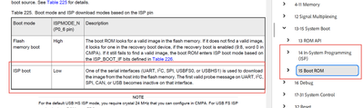

I am currently working with the MCX-N546VDFT microcontroller and have a few questions related to the hardware design:

Hello @Jain_Naman
  1. Programming with UART and USB: Yes, we can enter ISP mode, then use UART or USB to program the image into flash memory. For detailed information, please refer to "Part 14 ISP" and "Part 15 Boot ROM".
  2. Alice_Yang_0-1731036172469.pngPower Configuration Options: In a single supply configuration, all power domains of the device are powered by a single voltage source. This simplifies the power design and reduces the number of power supplies required.       In a multi-supply configuration, different power domains of the device are powered by separate voltage sources. This allows for more precise control over power delivery and can optimize performance and efficiency.
