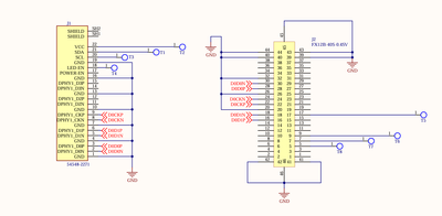

Q1 ) I wanted to ask about the connected i am using in mipi .
Image 1 :
image 2:
as shown in above "image 1" of the connected from the NXP Schematics there are many functional pins , like PWR_EN and others but in the connecter i have designed only has 3 set of differential pairs 2 data lanes and 1 clock lane with ground are these much connections are only needed to establish a valid connection in mipi with the FPGA Replacing OVA5640 camera or any other pins are been validated for proper connection.
Q2) I have also observed while Initializing MIPI CSI2 RX in NXP IMXRT1170 controller the while initializing the MIPI  CSI@ RX registers some hard_fault or bus error occurs due to which the code gets hang there and after that i am not able to flash code causing "error closing down debug session - Nn(05). Wire ACK Fault in DAP access" error

Sam_Gao
please refer to application notes AN13573 for MIPI CSI and AN12940 for MIPI DSI configurations on the RT1170 platform.
https://docs.nxp.com/bundle/AN13573/page/topics/features_differences_between_imx_8m_and_imx_rt_par.h...
https://www.nxp.com/docs/en/application-note/AN12940.pdf
690 Views
Sam_Gao
It is feasible to interface the i.MX RT1170-EVKB with an FPGA-based MIPI source, but the PXP module will require data format conversion to handle 12-bit monochrome data.
  • Q1. FPGA-based MIPI Source Interface: Interfacing an FPGA that acts as a MIPI CSI-2 camera source is possible. The i.MX RT1170-EVKB is equipped with a MIPI Camera Module Connector (J2) designed for this purpose. But we don't have such solution to support by using FPGA-based MIPI source.
  • Q2. PXP and 12-bit Monochrome Data: The PXP (Pixel Pipeline) is a 2D graphics accelerator capable of operations like color space conversion, rotation, and resizing , . However, it does not have native support for a 12-bit monochrome (grayscale) input format.
    • Supported PXP Formats : The PXP supports a variety of RGB and YUV formats, including 8-bit monochrome ( Y8 ) and 4-bit monochrome ( Y4 ),. There is no documented support for a 12-bit monochrome ( Y12 ) input.
    • Required Workaround : To process the image with the PXP, the 12-bit monochrome data must be converted into a supported format before it is passed to the PXP.
630 Views
