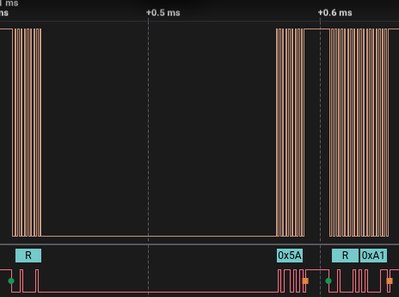

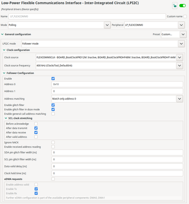

I'm using the default bootloader I2C pins (SDA = J7[3], SCL = J7[7], section 12.2.1) and slave address (0x10, section 14.8.1). The source clock I provide for the pins is 400kHz through FlexCOMM, although I'm not 100% sure that's what the communication speed actually ends up being, or if Bootloader uses my pinmux settings? I thought the Bootloader was supposed to adjust automatically, up to 400kHz (section 14.8.1) anyways. My digital logic analyzer suggests the actual clock rate is somewhere around 550kHz. Here's some screenshots if it helps.

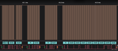

2. Send a Ping (Section 14.4.2) to confirm connection.
I write a ping, 5A A6. I read a ping response, 5a a7 00 03 01 50 00 00 fb 40. Great!

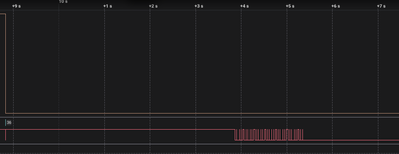

I write GetProperty, 5a a4 08 00 94 f7 07 00 00 01 00 00 03 00. I read a framing Ack , 5a a1. When I try to read more, SCL goes low, SDA goes high. I timeout after waiting 5 seconds, then SDA goes low again after some fuss, probably from the I2C master I'm using.

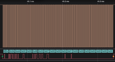

An update:
When you have a framing header on a command packet, the parameters, although 32-bits in length, are on a 10-byte boundary, so they're not 32-bit aligned. I forgot to account for that before.
Here's an updated GetProperty (current version, internal flash).
5a a4 0x 00 4b 33 07 00 00 02 | 01 00 00 00 | 00 00 00 00
This GetProperty does receive a response.
Ack
5A A1
GetPropertyResponse (status code = 00 00 00 00, current version = 00 02 03 4b)
5a a4 0c 00 05 72 a7 00 00 02 00 00 00 00 00 02 03 4b
If that fixes my other issues I'll update.
