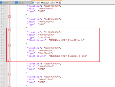

I am unable to flash a binary to MCXN947 evaluation board (MCX-N9XX-EVK) using the NXP LinkServer tool. The operation fails with a critical error and exit code 4294967295. The primary error appears to be related to the initialization of external FlexSPI flash drivers, which fails and prevents the entire flash process from completing. The target processor is in secure mode, and I am attempting to program the secure flash region at 0x10000000. Since we need to repurpose the QSPI lines  The power to the on-board external flash chip has been physically disabled on our EVK by removing a 0-ohm resistor.

  • Root Cause: The LinkServer tool is attempting to auto-detect and initialize all memory interfaces, including the external FlexSPI flash at addresses 0x80000000 and 0x90000000. The required flash driver (MCXN9xx_SFDP_FlexSPI.cfx) is failing its dynamic initialization, which causes the entire programming sequence to abort. This failure is expected and confirms our hardware setup, as we have physically removed power from this flash chip.

Harry_Zhang
Hi @wima88
You can change the FRDM-MCXN947.json in file C:\nxp\LinkServer_25.3.31\devices.
You can copy the JSON of the board and delete the external Flash region.
Harry
2,480 Views
wima88
Thanks !  Changers to the JSON helped

Harry_Zhang
Hi @wima88
LinkServer  will always try to probe and initialize flash interfaces it knows about for the selected target.
For the MCXN947 EVK, the default configuration includes internal flash at 0x00000000 and external QSPI FlexSPI flash mapped at 0x80000000 / 0x90000000.
If the base address of the image is in the 0x0 region, use the internal Flash driver (MCXNxxx. cfx).
If the base address of the image is in the 0x8000-0000 area, use an external FlexSPI Flash driver (MCXN9xx_SFDPFlexSPI. cfx).
So your image address is 0x8000000, which won't initialize MCXN9xx_SFDPFlexSPI. cfx.
