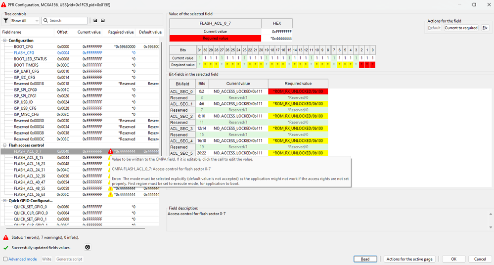

In Secure provisioning CMPA configuration, the default values shows an error and using the fix button before writing doesn't work. Reading the FRDM-MCXA156 values only show 0xFFFFFFFF on every parameter. Also, the terminal doesn't show the blhost command used (it does when verifying the connection).

Good question. If the processor is clear, there are 0xFF values in the whole flash and so the CMPA page is invalid and the flash configuration from CMPA is not applied. If you install CMPA using SEC tool, the flash access configuration will be applied and it is critical to set access rights properly.
There is not option allowing full flash access rights, so basically there is not "safe" default value. Each user needs to decide based on his application, what areas should be executable and what shall be read-only or shall be allowed for write. If the access right is not set properly, the processor will not boot.
This is the reason why SEC tool shows an error. The error is the "guide" to the configuration asking to be aware about the configuration and set it properly. To prevent to configure the processor into the state that it does not boot, SEC tool requires to set access right explicitly.

rj_engineer
Hi marek,
Thank you for the quick answer.
To summarize what we understand :
  • 0xFF everywhere is the default state of the chip after manufacturing and isn't taken into account by the MCU
  • To program the CMPA we need to set at least one area as locked and make sure the user code don't use it

Hi again,
0xFF everywhere is the default state of the chip after manufacturing and CMPA isn't taken into account by the MCU
Correct!
Not true. You can set access to all regions to "ROM_RX_UNLOCKED" for example, which means the code can be executed, the flash can be read but the code cannot modify the flash (write not allowed). Unlocked means you can modify access in the runtime
Are the CMPA only one-time programmable?
In development life cycle, it is possible to update CMPA several times.

rj_engineer
Does is it mean that we can set all regions to full access if we set one in "ROM_RX_UNLOCKED"?

marek-trmac
Hi, which from the available options do you call "full access"?

rj_engineer
We refered to the "DEFAULT_RW_UNLOCKED" but after re-reading, it appear to be a misunderstanding on our side as it must mean only read and write access (not execute). That automatically answers my question.
I will mark your first answer as the accepted one.
